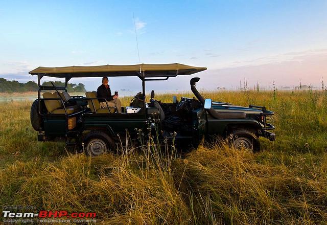

There exists a vehicle which just about matches my requirements - the Tata TL 4x4 which the Taj safaris have modified to be used as safari cars
Thinking Aloud : 4wd Offroad capable Jungle Safari vehicle.....the build is on-junglesafari.jpg
Thinking Aloud : 4wd Offroad capable Jungle Safari vehicle.....the build is on-11.jpg
Thinking Aloud : 4wd Offroad capable Jungle Safari vehicle.....the build is on-12.jpg
Thinking Aloud : 4wd Offroad capable Jungle Safari vehicle.....the build is on-13.jpg
But the drawbacks of these vehicles as far as I am concerned are that they are too heavy, engine too complicated to be fixed by the local mech, the engine is too noisy, besides the fact that I dot have a budget of 7L for this project I am operating on a tight budget of 1.5 to 2L at the most considering that this is only going to be a hobby vehicle which is going to be stationed at Tadoba and will be used only when I visit there.
To address these issues I have been thinkig for sometime now to delve in this project.
To come straight to the point, i am thinking of the following lines :

Notice how the Gypsy looks small as compared to all the rest all.

I would also want the vehicle to be super reliable and hence my apparent search for a relatively maintenance free base vehicle (which I felt was a Sumo)
What are the various engineering challenges that I need to address to get this project through ? Pardon my ignorance but I am here to understand the expected problems ad avoid them.
Nothing wrong with the gypsies, but can I think of 3 rows of seats in the bay area of the Gypsy ? You need to come with me for a wild photo shoot to understand the shortcomings in a gypsy. sometimes when I take a lot of equipment and long lenses, I have to remove one of the 2 side facing seats at the back or at times both of them and keep a mattress in the bay area to keep my stuff.
Thinking Aloud : 4wd Offroad capable Jungle Safari vehicle.....the build is on-img_8371.jpg
observe that to use this lens we had to remove one of the side facing seat in the gypsy rear.
Maybe Fazal saab will be ale to throw more light on the practical difficulties a serious shooter faces during these drives.
Any other simple , low cost second hand vehicle that I may use as my base vehicle for this project that I may be missing out on ?
