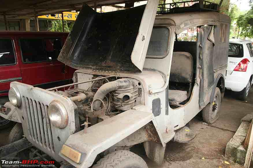

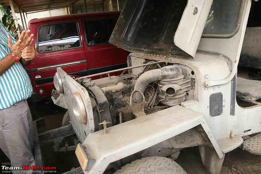

What Mahindra Jeep is this ?
This seized jeep is for auction in a couple of days in Nagpur. A friend is planning to bid o it to acquire it for keep sake and conversion to 4wd (this doesn't have 4wd at present)
What should be a good price for the max bid ?
I also want to know the details of the engine in this and the details of the parts that are required to convert it into a 4wd vehicle.

http://www.team-bhp.com/forum/2034488-post2.html
Looks like the 2nd blue jeep with 2 side entry points, and 1 rear entry. I think it is the 650DP but with a DI engine. If it is from a govt auction, and with decent mechanicals, 35-45K is the max, Sabareesh from Tbhp got a similar conditioned CJ500D from mumbai for 35K.
Edit - not the 2nd blue (with round fenders) but the 1st pic (a commander i think) with flat fenders.

it is a Mahindra Jeep Commander 650 DI.

What will it take to get this converted to 4wd ?

4WD Conversion
Hi Doc,
ZACS is right this is a Commander 650DI.
To convert this to 4WD.
1) MM540 Front Diff Assy (51"Track) with 4.27:1 Diff-Ratio (Please check Rear Axle)
2) Rear Axle. Check the diff-ratio. Use the existing Rear Axle if
a) Diff Pumpkin is centre
b) Diff Pumpkin is off-set right (from Rear)
3) Gearbox & T-Case (KMT90+T18) you will need a bell housing if the existing 2wd setup is 3 Speed.
4) Front Prop Shaft.
5) Rear Prop Shaft.
6) 4WD Cross member with V-Fork for Spike Arrestor/Spike Arrestor/Skid plate & Cross Member spacer if applicable.
7) Under the Chassis Bump-Stops for Front Axle & Rear Axle.

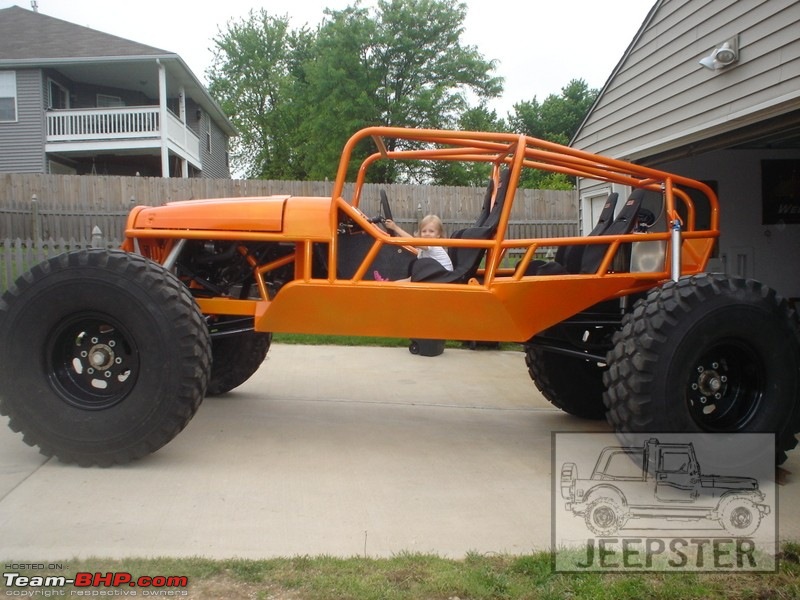

in the international scene more & more people (offroaders) are going for lwb's .(ex. jeep jk)
most custom extreme hard core offroading vehicles are in lwb range.
