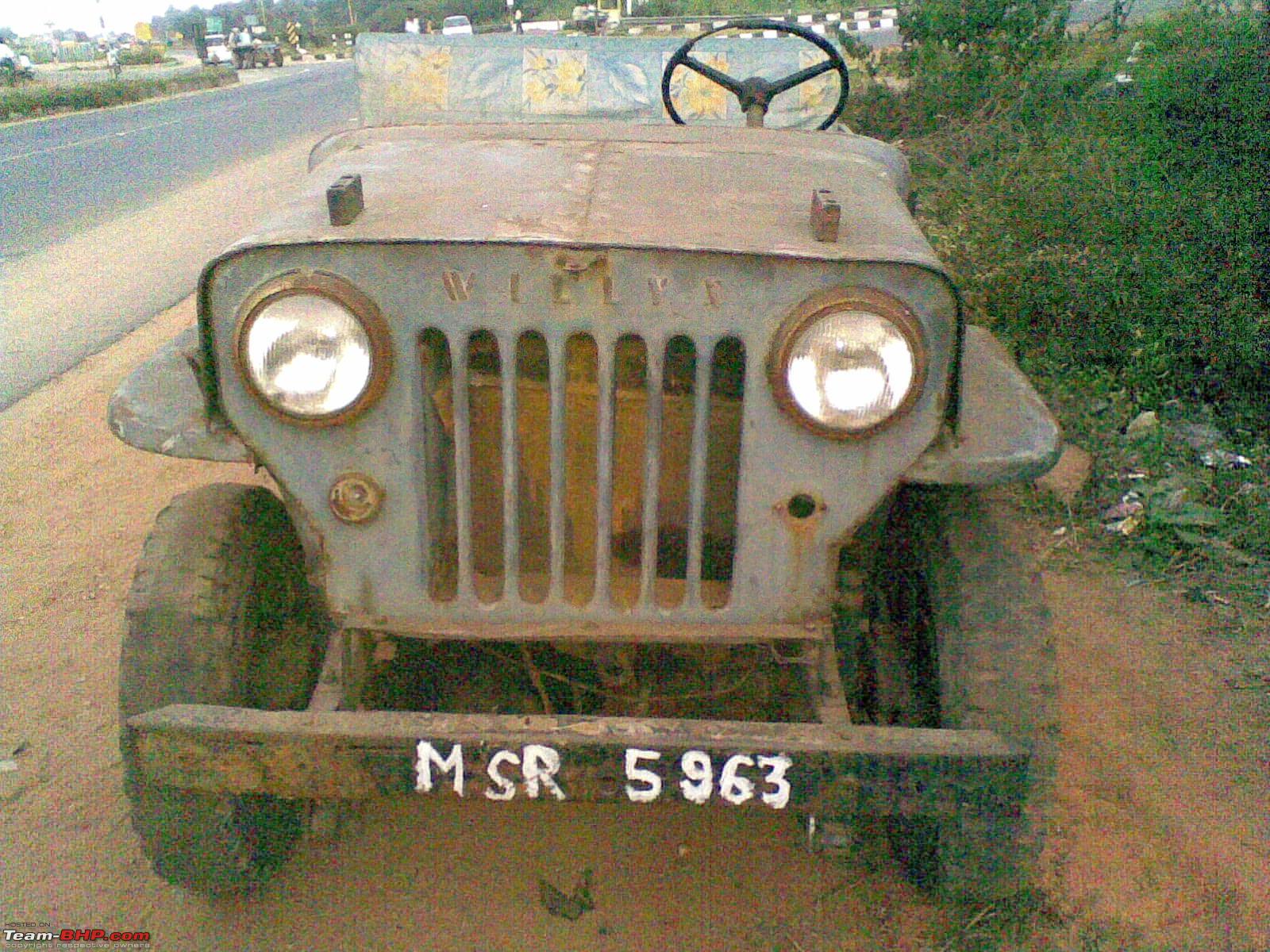

This is the first post in the lines of restoration of the CJ3B body, electrical and few cosmetics. The I would call the current state as phase one which is identification of all the necessary tasks and planning for procurement of few parts which are missing.
The following picture will give an idea of the jeep in its current state, however what you see on these pictures are only the body condition. The drive terrain of this jeep is perfectly good and engine cranks super quick.

Body is busted, may need a nearly new overhaul. I see the hand brake cable in place..!! Neat. Looks like there is only 1 way to bring this jeep back to life, and it is surely not a 1-by-1 approach - needs a COMPLETE strip/rebuild.
