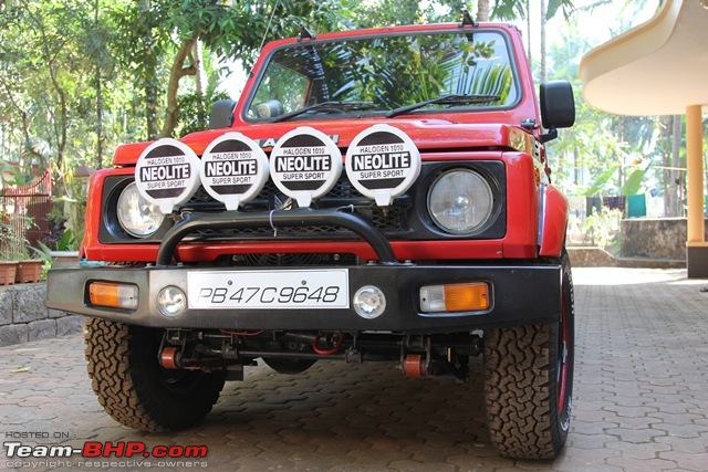

Good looking Gypsy. Some comments:
1. The exhaust is prone to damage in that position during offroading. If you don't do off-roading then no problem
2. The front bumper is mounted about 1 - 1.5 inches too low! This will hinder your approach angle slightly.
3. You should have also recessed the fog-lamps on the front bumper like you have recessed the indicator lamps.

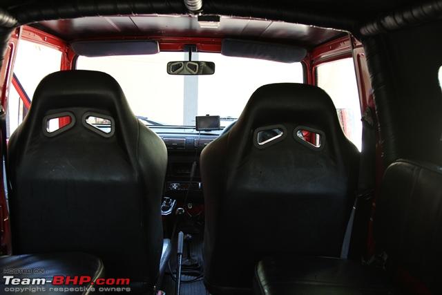

4. Can anyone sit in the back without rubbing against the soft top?
5. For better AC efficiency you should get an insulated partition made between front and rear cabin space.
Thanks for your comments, Guru. Your gypsy has been an inspiration for me.
I am not planning for any extensive off roading as of now, but will look at the exhaust and bumper reworking.
Excellent idea to get the fog lamps recessed, will get it done.
And about the aircon, am planning to get a rally cabin after the registration process. So should not be an issue after that.

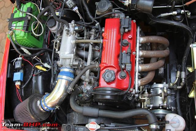

Good looking Gypsy. Is this bracket fabricated or a standard part?
Please route all your wiring's in the engine compartment properly, will look much better.

The part shown is fabricated at a local workshop in Calicut.. The original one was longer and snapped during the drive down to Calicut.
According to the mechanic this is still not a good fitment and he is fabricating a four-way bracket for a better fitment of the same part.
