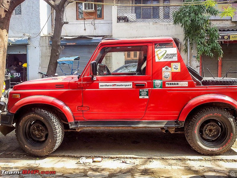

Iqbal and rmonie
Thanks for your comments. Buddy I do not have the pictures of me fixing the stickers on the vehicle but yes definitely have some pics of the Team-BHP stickers on the vehicle
Please find enclosed some pics.
