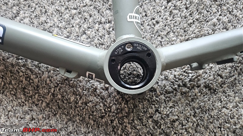

Uses eccentric bottom bracket shell for making single speed conversion easy. But thankfully installing new threaded BB inside it is no different from a regular BB shell. I used a DUB 29mm road bottom bracket after removing the original square taper.
