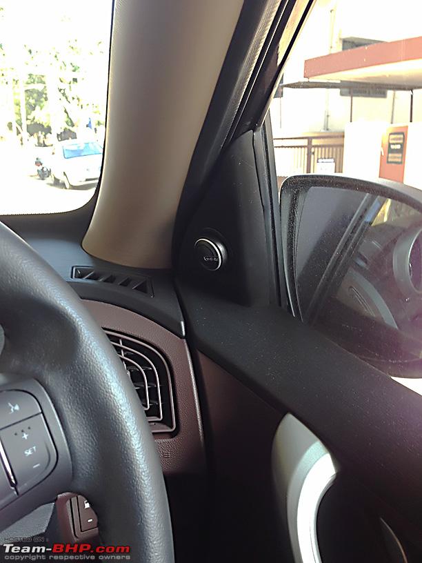

OK, just ran down to the parking lot and snapped these for your reference. My XUV is a W8, so I couldn't mount it on the pillars since there are air bags in the B pillars. If you are buying a W6, the pillars would be a better option. On a W8, these seem to be the only place to mount them.
Front tweeter mounted on the front part of the window frame:

Thanks very much, Stryker! Genuinely appreciate it! I am guessing that mounting the tweeters would require drilling into the plastic surfaces. If only Mahindra could have provided better speakers by default. Sigh.
You are welcome, TNAWAYAJ. Yes, the tweeters require drilling, but the dealer has done an excellent job of this. They do have specialized tools for the same, so there is no awkward gaps or anything like that.
