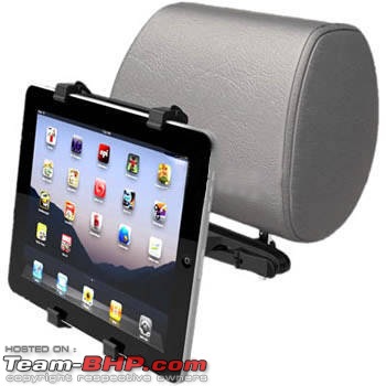

Originally Posted by HotChillyPepper (Post 2868476)
This is an idea i thought about too. But on long distance travel, it will be really painful to hold the tab and sit. Headrest display would be easy for elders.
I was thinking more like the following (image picked from the net. Copyright with original creator)
ICE upgrade : Mahindra XUV500-carheadrestholderforipadipad2tabletpc.jpg
Originally Posted by HotChillyPepper (Post 2869153)
And the build quality of the unit is on the down side by looking at the pictures. I don’t think I will go in for this option.
Somehow I was pretty sure that you will come to that conclusion. Accessories -even the so called OEM once- stick out like a sore thumb in most cases, especially on the quality and fit&finish front.
I checked the details of head rest screens and it is not a simple setup as i thought. The one's M&M calling as Genuine accessory is a standalone 7 inches unit having its own DVD tray beneath the screen and a USB port for USB devices. The audio is transferred through FM transmitter to the main head unit. Power will be taken from tapping some wires around B pillar. Price including both screens would be around 15K.

Originally Posted by DoneAndDusted (Post 2898706)
Thanks HCP and SDP for sharing your thoughts. May I ask which options you guys finally went with?
I have ruled out the genuine head rest option for sure. They are really cheap with WQVGA (480x240) display resolution. So buying a proper ipad dock for the head rest would be the best option. You can also buy the cheaper tabs with 10.1 inches display from eBay, that will be safe to leave inside the car while parked. But one should buy tabs with Bluetooth A2DP so that you can connect it wireless to the XUV audio.
HCP.
HCP.
Thanks HCP! Most of the cheaper tabs have bad screens, the nexus 7 with its feature list and reasonable pricing is the best bet IMO :).
On the bluetooth front, I agree with you to help with connectivity, but since these will be used by the rear passenger (read my kid and parents/in-laws), I am not sure if I would like the sound to be connected to the HU. Won't this mean we will only hear whats being played on these devices? I would rather have the rear passengers use the devices speakers or use head phones rather than make me hear cartoons or boring serials while I am driving :)
