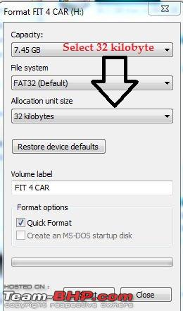

So this time I applied a little trick to not to use factory formatted drive and remove the password/secure access application too, so I opted to format the drive on a win7 laptop,
I selected a different "Allocation unit size" this time selected "32 kilobytes"
and voila, the transfer speed was 8MB/second which came to stable 4-5MB when I was copying large bunch of mp3's
Took screenshot, but i misplaced it on laptop somwhere, will post it later if needed.
USB Drives - Improved the Read / Write Speeds!-61eyn.jpg
Ofcourse there's more to this technical aspect of file system but this worked like a charm for me, without any problem, my JVC HU plays the stuff off this drive and It copies files real fast for me.
So if you are planning to get rid of your long sized USB Drive and buy a sandisk cruzer Fit, make sure you try format it with Allocation unit size as 32kilobytes instead of default value of 16 kilobytes which is shown as default on format window.
