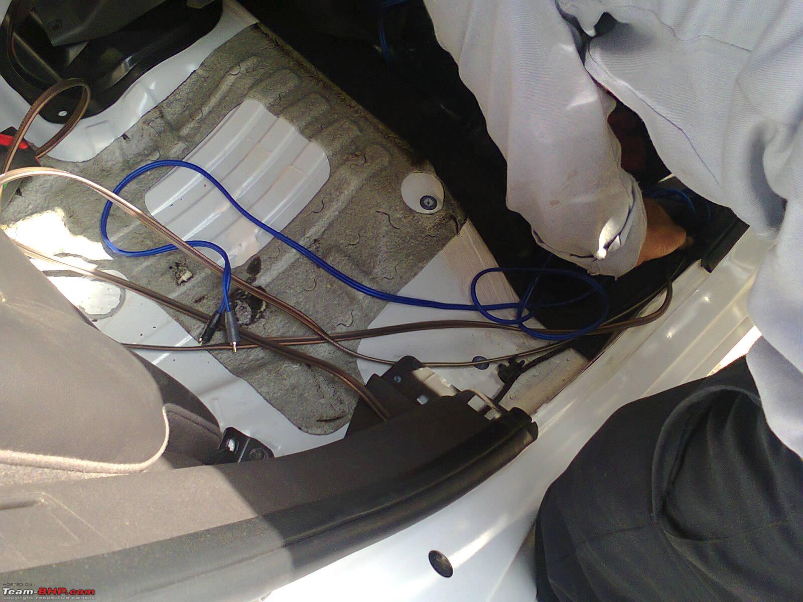

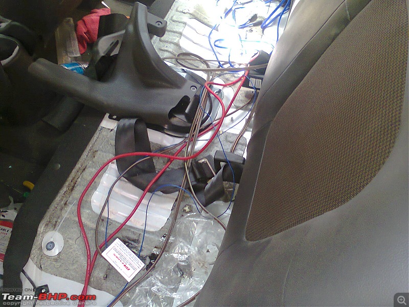

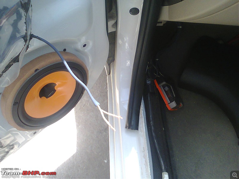

Dear Friends,
the car is about to complete one year in july with 16500kms already on Odo.
Having lived with the strictly average stock ICE i20 comes with , the desire to upgrade the ICE was growing every day.
Though the stock speakers were replaced after 1 month itself, the stock headunit was not doing justice at all. so finally decided to add an AMP.
Below is the breakup of the upgrade.
Installation was done at Driven, East of Kailash.
Speakers Front- Hertz ESK Components Rs 7500
Speakers Rear- Rockford fosgate prime series 6 inch coaxials. Rs 2200
Amp-Kenwood 846 - Rs 5500
Bull audio 8 gauge wiring kit - Rs 2300
Speaker wire- awg Rs 150/mtr. total 16 mtrs.
Hi/lo converter-Connection Rs 4400
Extra RCA ,Bull audio- Rs 400.
Total expenditure-Rs 22,400/-
installation was done in a very professional way & all the wires were laid neatly.
sound output and quality is vastly improved over the stock unit. Mids and Highs are clearly defined , the front components deliver decent bass too!
Budget constraint prevented addition of Sub, though it will be added in a month or two. Need advise from bhpians on this, as the amp is rated at 60W RMS*4 . Not very power full.
Below are few pics(average quality!).
