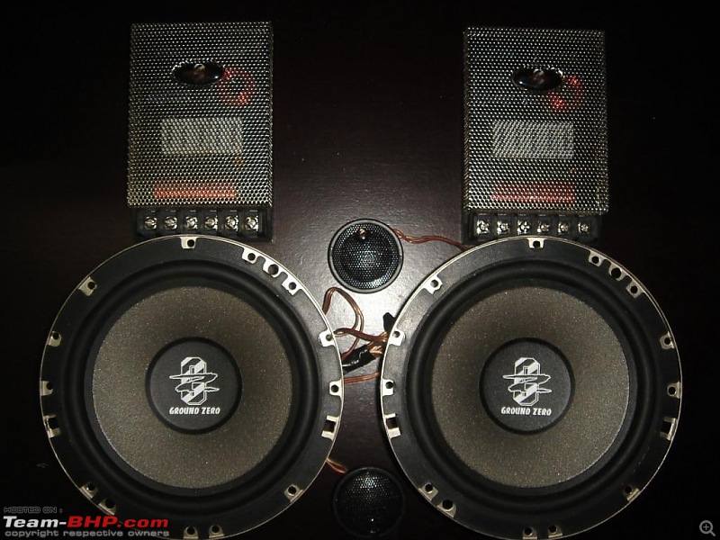

Upgrade pics.
Here we go.
ICE upgrade : Maruti Swift-13092009079.jpg
ICE upgrade : Maruti Swift-13092009080.jpg
ICE upgrade : Maruti Swift-dsc02563.jpg
ICE upgrade : Maruti Swift-dsc02564.jpg

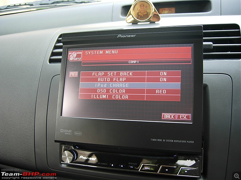

Ice
I have attached my HU PIC check this out...
ICE upgrade : Maruti Swift-picture-090.jpg
ICE upgrade : Maruti Swift-picture-093.jpg
ICE upgrade : Maruti Swift-picture-095.jpg
ICE upgrade : Maruti Swift-picture-099.jpg
