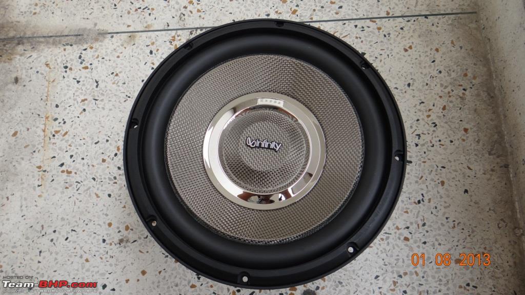

The Subwoofer
Asking for an SQ setup required looking for a sub that would provide tight controlled (not boomy) output when set inside a sealed enclosure, within a budget of 15K. Very early in my planning stage this great review of the Infinity Kappa 120.9 sub was published.
http://www.team-bhp.com/forum/produc...er-review.html
Admittedly I did hunt around for ID/IDQ subs, but this great company has shut shop. In 2012 snapdeal came up with some IK 120.9s for sale at half the price, a deal I - err - snapped up.

Love the build quality on this baby:

Lots of queries on the cost of the setup. Here goes:
Rainbow Soundline Components - 20K
Infinity Kappa 120.9 Sub - 7K (Stock price 15K)
Audison LRx 4.1 - 40K (Stock price 62K. This is only a limited stock/limited period offer, I'm told)
Damping (Dampmat) - 6K (6 sheets for the front and rear doors)
Damping (Stinger Roadkill Expert) - 6K (4 sheets for the boot and parcel tray)
Cabling (Total) - 6K
Installation - 2.5K (incl MDF board and carpeting in the boot)
Total Cost - 87.5K
