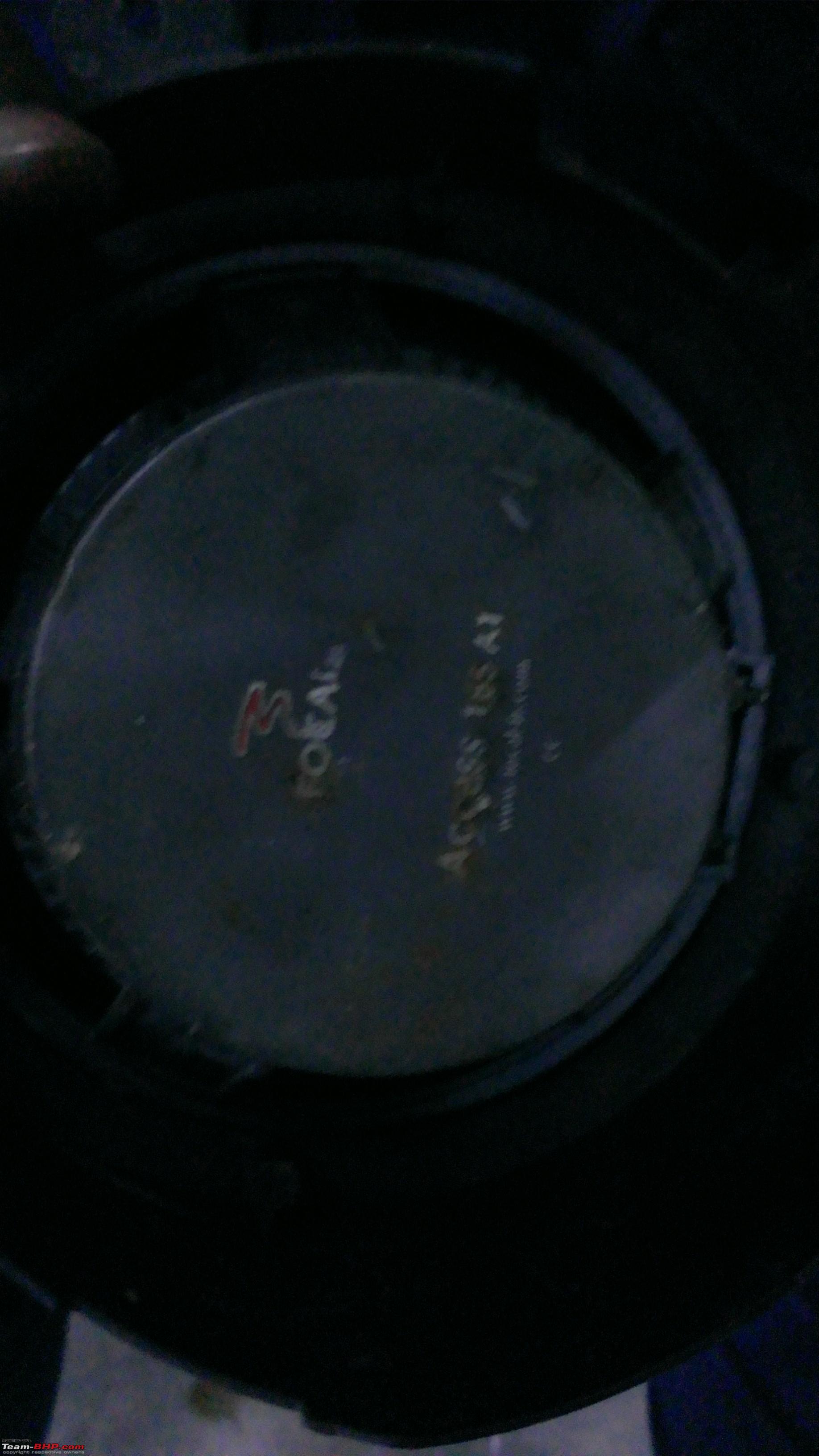

Front door :- Focal 165 A1

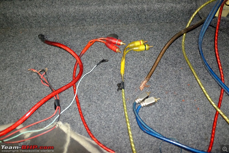

Trunk:- unconnected wires

Get ird of ALL the wiring, i cant emphasize on this enough.
The wires in the photographs are horrendous.
Most of the RCAs are cheap ones of BOSS make.
Attachment 1179087

Ok what you got is an Alpine HU (this is not the HU Skoda supplised - the OEM HU was the Alpine 9830) and pair of speakers (Focal in the front and Kicker in the rear).
This system is acceptable and for a minimum invenstment (wiring) you can just drive all 4 of these speakers directly from the HU.

BTW from what I can see of the wires left in your trunk the previous owner has used a monoblock and a 4 ch. amp (as recommended above). Granted the wires are ordinary but I would check the Live Level converters (you will find 4 of these behind the HU) in case they are of good quality. Why spend when you don't have to.
