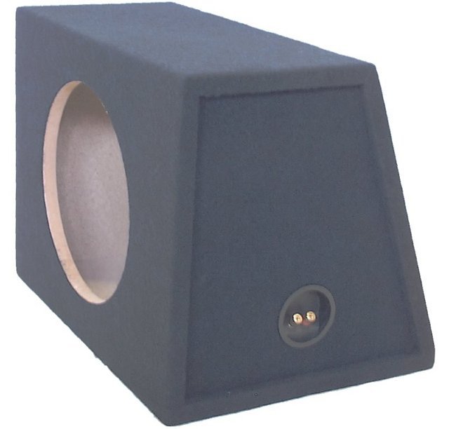

the enclousre size outer dimension 1 x 1 x 1.55(12x12x18) = 29.8 ltrs
for ur sub optimal volume would be 14x14x18 = 42 ltrs
sorry to bother you again !!! can you just point out in the pic below which is to be 14.. 14 and which side is 18. I think I have an idea of this.. but its bothering me just wanna be sure.
and by the way 14 + 14 + 18 = 46 ltrs
so is it 42 ltrs and + 4 extra for the sub volume??
man man what are u doing man this is wrong:Frustrati
this like this
14 inch X 14 inch X 18 inch
or
34.3 cm X 34.3 cm x 45.7 cm
this comes to 34.3X34.3X45.7 these are outside dimensions so we need to deduct 19+19 mm from each side (two sides)
so it comes to
30.5 cm X 30.5cm X 41.9cm
now the internal volume comes to nealry 39 liters
this is how it comes this is close to 42 liter for which we can use this box volume calculater....
