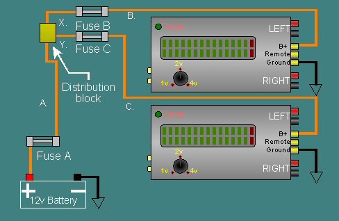

Ok now I have a few questions, regarding the fuse/ dist. block if I am to use finolex/molex type cable for power.
Here is what I 'suppose' is correct :
1.Connect 4ga wire(in my case the finolex cable) to the car battery (+12V)
2. Connect this wire to a fuse holder?
3. Connect the wire from the fuse to a
dist. box
and then
4. Connect from dist. box to 2ch (4ga and ground it)
5. Connect 2ch to the Alpine(4ch) (8ga and ground it)
Now regarding dist. box, we are talking about power dist. right?? If the basic dist. boxes provide for 1 -> 2 split then I guess i dont need to follow step 4/5 and the amps can be wired individually?
Also what sort of fuse would I require for the setup in question, and this needs to be hooked up to the cables running from the battery BEFORE the dist box correct? (Id also read that a fuse is necessary when you switch from bigger wire to smaller...)
spot on souljah.Up to step 3, u r right.And then u have to follow ur own alternative to ur steps 4&5, i mean from dis block to both amplifier with fuse.NO WAY U CAN DO IT WITHOUT FUSES UNTIL OUPUT WIRE IS OF SAME SIZE.

LBM,u r talking about those fuses which we need even when we dont need dis.block but u dont have for changing the size of wires.As pointed by above website[and by gunbir in prev post,i cud lead to some fire hazard]
this is what
www.bcae1.com has to say.......
In the next diagram, things get a little more complicated. As you can see, wire 'A' is used to deliver power to the distribution block. Wire 'A' is of a large enough gauge to power both amplifiers. 4 gauge wire is commonly used as a main power wire. Fuse 'A' must be rated to protect wire 'A'. Any fuse rated at less than ~150 amps is sufficient to protect a 4g wire and the vehicle (if the 4g wire is longer than ~15 feet long, you may want to limit the fuse to ~125 amps). Again, fuse 'B' protects wire 'B' and fuse 'C' protects wire 'C'. Wire segments 'X' and 'Y' MUST be as short as possible because, unless they are of the same gauge as wire 'A' (or larger), they could be a fire hazard.
In most cases, the wire size is reduced at the point of distribution. ANY time that the wire size is reduced, you must add a fuse in the line (at the point of distribution) to protect the smaller wire. Look at the following for more detailed info about changing wire sizes.
Originally Posted by rsjaurr NO WAY U CAN DO IT WITHOUT FUSES UNTIL OUPUT WIRE IS OF SAME SIZE. |
rsjaurr you are right but he is not doing such technical setup of install every fuse. There will be a main fuse at the battery and there are fuses built in the amp. so no need to worry about it.

Since Im on a budget icing, the question of multiple fuses shouldnt even be considered as an option.
Im asking whether the following scheme........
finolex 70sq mm. cable (carries 160 amps?) ---->
fuse holder ----> Dist. box (x/y)
Dist. box (x) ----> 2ch amp
Dist. box (y) ---> ----> 4ch amp
............would be a reliable alternative to the multi fuse setup and also not making insecure/hazardous connections since there is a dist. block in place.
Dist. box (y) ---> ----> 4ch amp |
70 mmsq :Shockked: man are u installing 4 amps or what....u will be easily working with 35 mmsq.....dont go at 70mmsq......
http://www.the12volt.com/wiring/recwirsz.asp check this out for load rating...
get a fuse holder near the battery..no need for distribution block...do the split wire thing......It will be a cheap option to protect the wire further got to a good electrical shop ask them for wire sleeve it will help u in further protect the wire from any accident.......

Originally Posted by low_bass_makker 70 mmsq :Shockked: man are u installing 4 amps or what....u will be easily working with 35 mmsq.....dont go at 70mmsq...... |
sorry meant to say 35... it will roughly put out the same as 4ga right... most of the amp kits have included fuses of 150anu...
Hope it doesnt appear as if im asking the same questions again and again....... I just want to make sure...

Originally Posted by s0uljah sorry meant to say 35... it will roughly put out the same as 4ga right... most of the amp kits have included fuses of 150anu... |
the 35mmsq comes close to 2 gauge not 4 gauge here is good chart about that info....

My understanding is that the fuseholder(near the battery) has less to do with the amplifiers and more to do with power cable, viz : the fuse is protecting the cable/battery... and not the amps. Correct? and the inbuilt fuses in the amp would be taking caring of the requiremtents
so with a 150A fuse, If I use anything smaller than 4ga, it will cause it to short?(keeping in mind that car batteries would easily produce enough power to blow the 150a fuse)
So using the above method of 35 sq mm cable, could I safely use the 150A fuse?
And if I run this wire into a dist. block and then use smaller wire to each amplifier (individually) would I be at the risk of shorting or other such issues?
