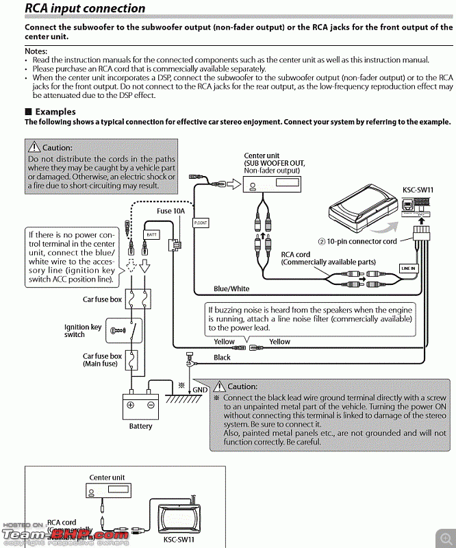

Moreover, when I look at the product description page and user manual for the KSC-SW11, I see that it supports two methods of connection:
  • Via the speaker wires
  • Via RCA cables
While there's no indication as to which of these outputs are present in the head unit of the Aspire, the information should reassure you that its one of these.
Here are the connection diagrams from Kenwood (not Ford) for each input type:
Ford Figo Aspire: ICE Upgrade-speaker-input-connection.gif
Ford Figo Aspire: ICE Upgrade-rca-input-connection.gif
You might want to consider products like this:
