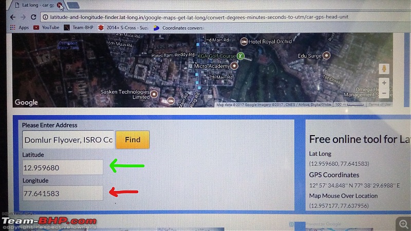

First things first - You need to find a reliable online service that gives you the longitude and latitude data of your place of interest. I found the below online service to be reliable and also gives me the latitude and longitude to a accuracy of 6 decimal digits.
Longitute & Latitude Finder
With this service, you can find a point of interest such as your home, favourite restaurant, a dangerous curve in the highway etc and find the latitude and longitude of the place. Example

Unfortunately, if your longitude and latitude data is not accurate to about 6 decimal places, then you will end up somewhere else. It will be off by several KMs or probably even more!! I found that the system does support accuracy of 6 digits. Thus a line of data should look like this
77.641721,12.960345,Domlur Flyover,Bangalore,<Phone Number Optionally>

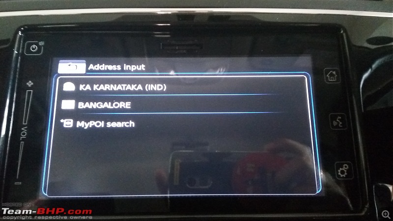

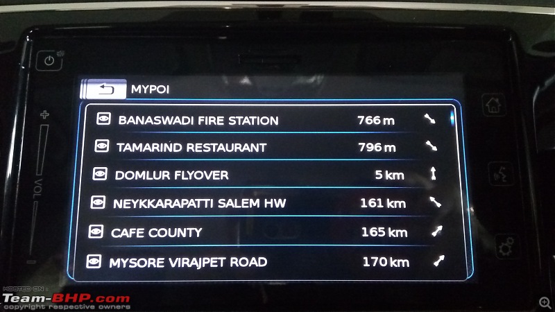

Select MyPOI Search
Importing Custom Map POIs on your Maruti SmartPlay Infotainment System (Suzuki SLDA)-page2.jpg
Importing Custom Map POIs on your Maruti SmartPlay Infotainment System (Suzuki SLDA)-page3.jpg
Importing Custom Map POIs on your Maruti SmartPlay Infotainment System (Suzuki SLDA)-page4.jpg
