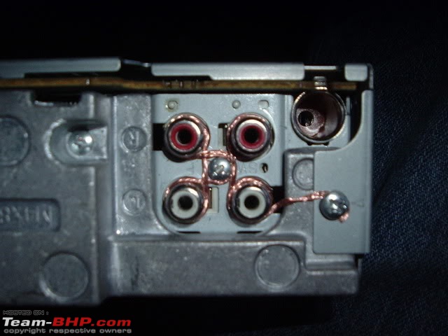

I had this issue long long ago in my WagonR. I was running on a Set-up with a 4 Channel Amp and component speakers for the front.
All of a sudden one day, I hear noise like a blown fuse and then everytime I rev up, the whine intensity would increase.
Found out after a lot of reading and searching then that it was the infamous alternator whine. My issue was strictly when using the speakers connected via Amp.
So when I troubleshot, I realised that the noise was gone when I connected speakers directly to the HU, isolating the Amp. But then, I also used a different source (MP3 Player) with a Stereo (3.5) to RCA and then played back through the same speakers via Amp to figure out if that was the Amp. Luckily it was perfect when I played using the MP3 Player as the source.
Changing RCA cables never helped. The ultimate jugaad around this was to ground the RCA at the back of the HU onto the HU chassis itself and that worked.

In your case as R2D2 says, you need to first check all the connections, insulation and any open circuit running from HU to the speakers first.
And since you mention this is now an issue with all 4 speakers (F & R), it is the Head Unit that I suspect. If your ASC can plug in a similar HU from their own vehicle (I am sure they should have) and test it in your car, you will find the culprit.
In fact, remove your Storme's HU and connect to another one and check and that will further confirm too.
Pulling out the stock HU is easier, and so is removing the OE couplers from behind so its a fairly easy way to go ahead.
