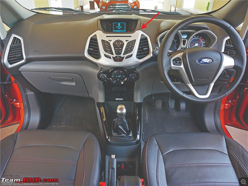

Alas, I started looking for more alternatives, and I came across a very interesting fact that I don't think many people know about.
The design of the bottom half of the part that houses the screen is different in the Trend variant and the Titanium variant.
ICE Upgrade : Ford EcoSport-titanium-dashboard.jpg
ICE Upgrade : Ford EcoSport-trend-dashboard.jpg
This causes the aftermarket units to not fit in the lower variants & thus, eliminating it from my list as well.

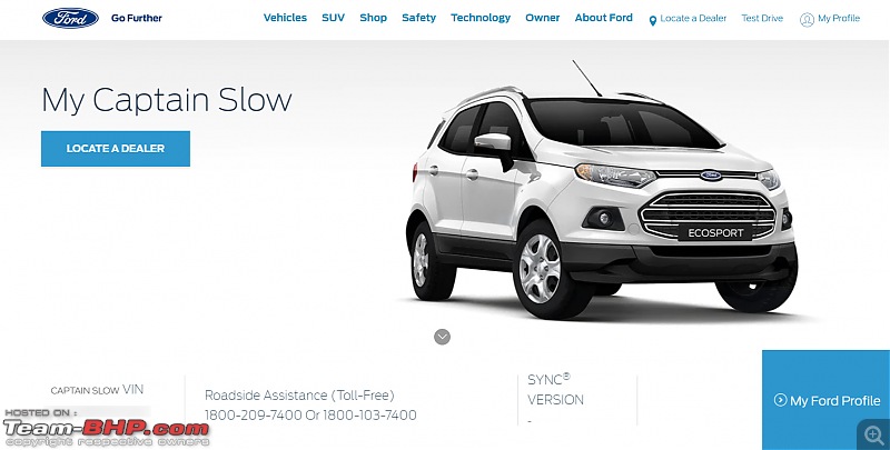

As you can see, my EcoSport doe not come with any version of SYNC.
However, I will contact the seller to enquire if there is something available for my variant.
