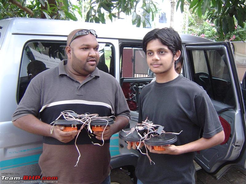

8. Rainbow SLX series 6.5" coaxials.
Again, Yes! The components from the rear were changed too. I don't think I have to explain why and how in this case.
