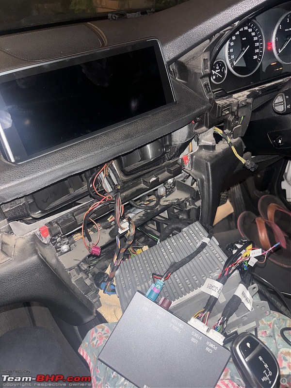

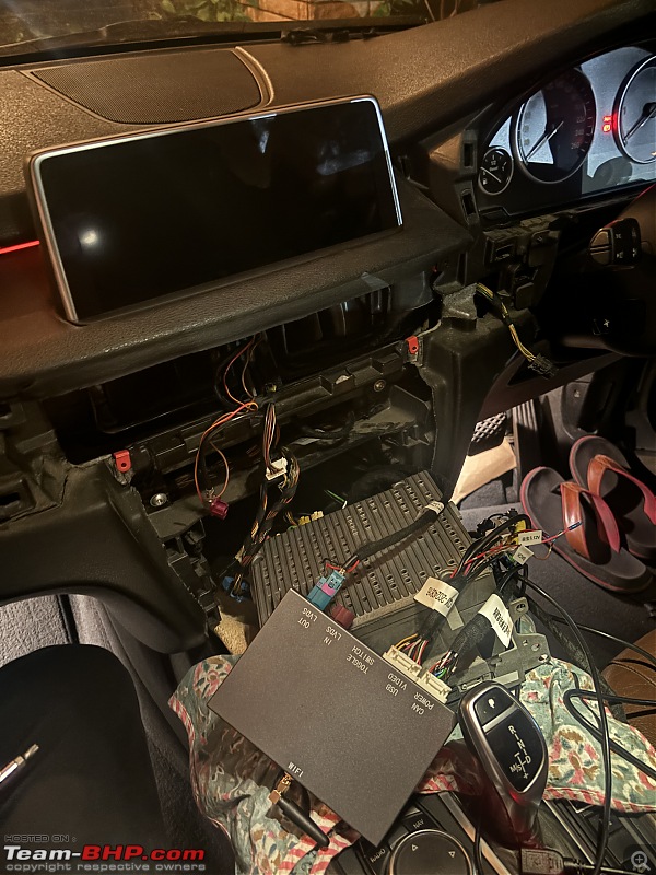

No wire cutting, it’s plug and play. However, the tough part is putting the module inside. Check some YouTube videos and just follow them. You would have to find a place in the bottom right side corner to put the module. No show stoppers as such, but one important thing was that they told me the ‘mic’ cable was irrelevant, but since I did not attach that cable, I have to switch on my iPhone from ‘BMW X5’ to ‘CarPlay’ every time I get a call - this part is a bit buggy, but sort of living with it.
Considering the actual price and how BimmerTech and other companies are looting, this seems like a good deal. Just the mic part is annoying.
Attached some pictures of the process
Added Apple CarPlay with Bimmertech MMI to my BMW 3-Series (G20)-img_6295.jpeg
Added Apple CarPlay with Bimmertech MMI to my BMW 3-Series (G20)-img_6294.jpeg
Took a leap of faith and installed it myself. Thankfully didn’t mess up anywhere.
Last edited by Turbanator : 21st January 2025 at 09:58. Reason: Merging back-to-back posts. Let's not talk about under invoicing. Thanks
BinoyR is offline   (1) Thanks
