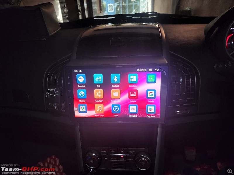

The apps screen

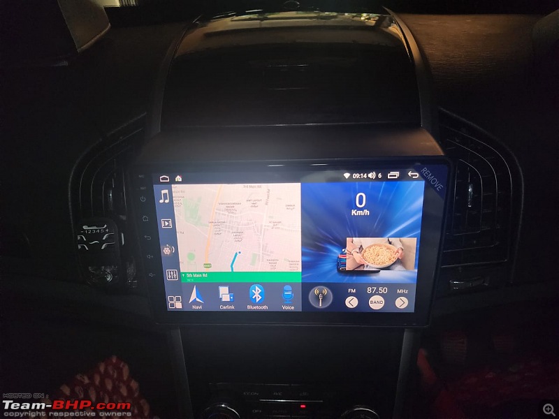

Maps plus video in Picture in Picture mode

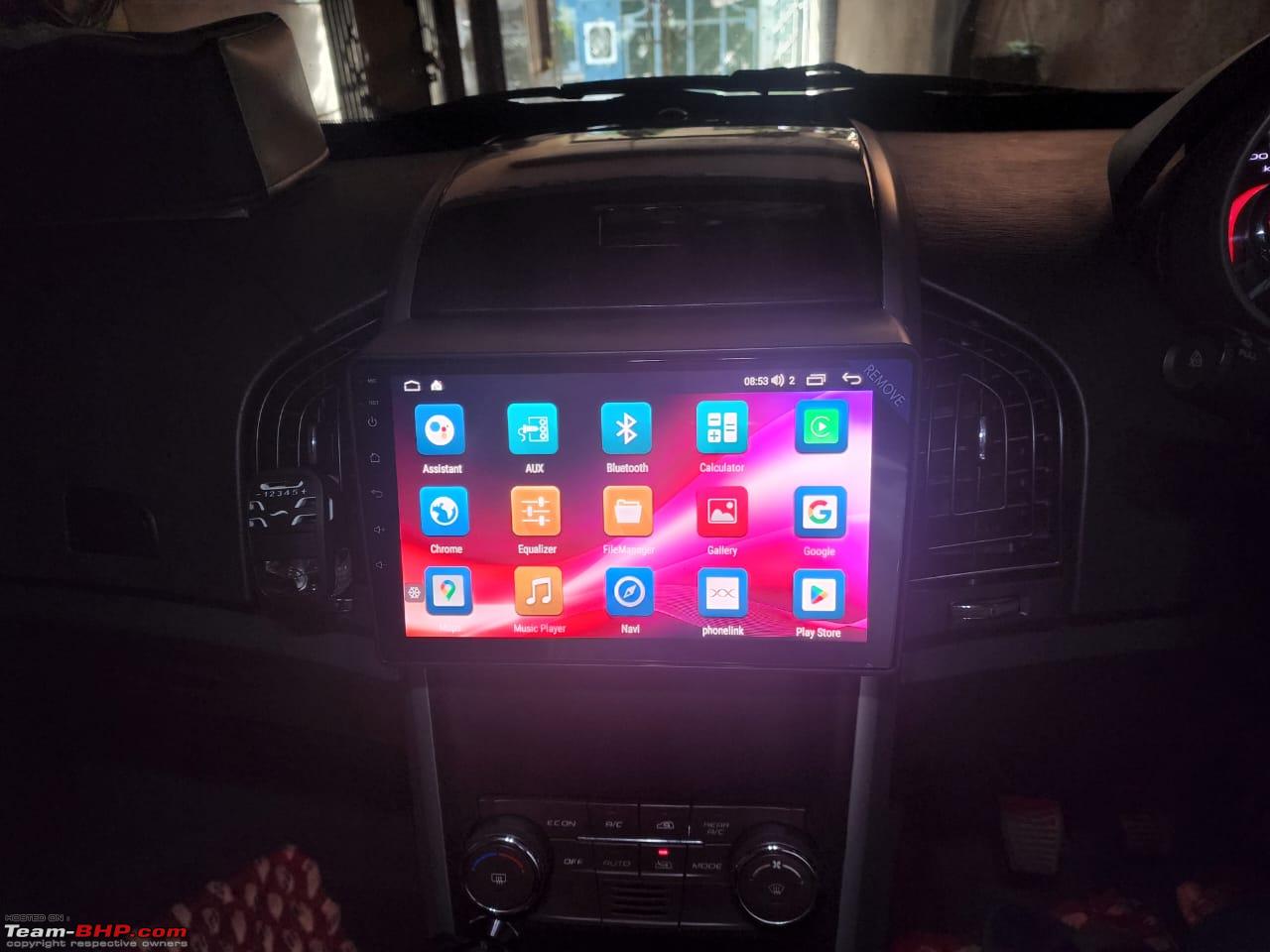

Climate control settings and display

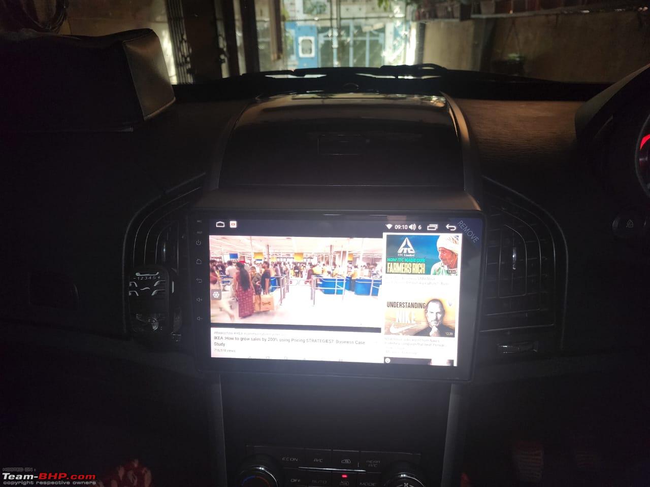

Youtube
