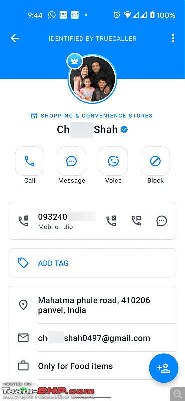

And then, instead of calling my Mum - who is in my contacts and also has a "nickname" saved as 'Mom' precisely for voice-to-text phonetic reasons...
Android Auto - How to stop Google Voice Assist dialing numbers from the internet-screenshot_20230517094344.png
... it instead proceeds to call this person!! Who I don't even have in my contacts and have never called before in my life
Android Auto - How to stop Google Voice Assist dialing numbers from the internet-screenshot_20230517094417.png
This happens repeatedly.
