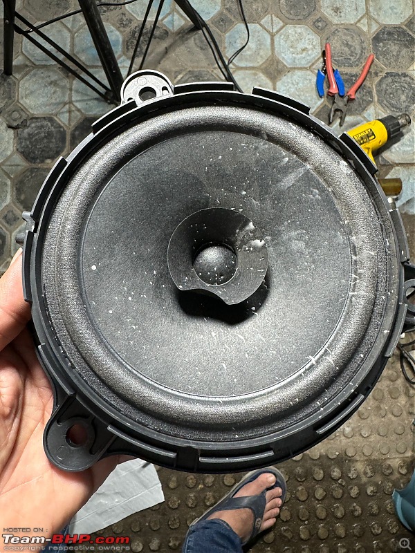

Upgraded the audio system in my Nissan Magnite | Component speakers, 2 amplifiers, subwoofer & DSP-whatsapp-image-20241014-4.12.44-pm-1.jpeg
The stock speakers that come with the Nissan Magnite are subpar to the core. I've been tolerating this lackluster sound for the past two years. Now that my warranty has expired, I finally have the freedom to replace them!

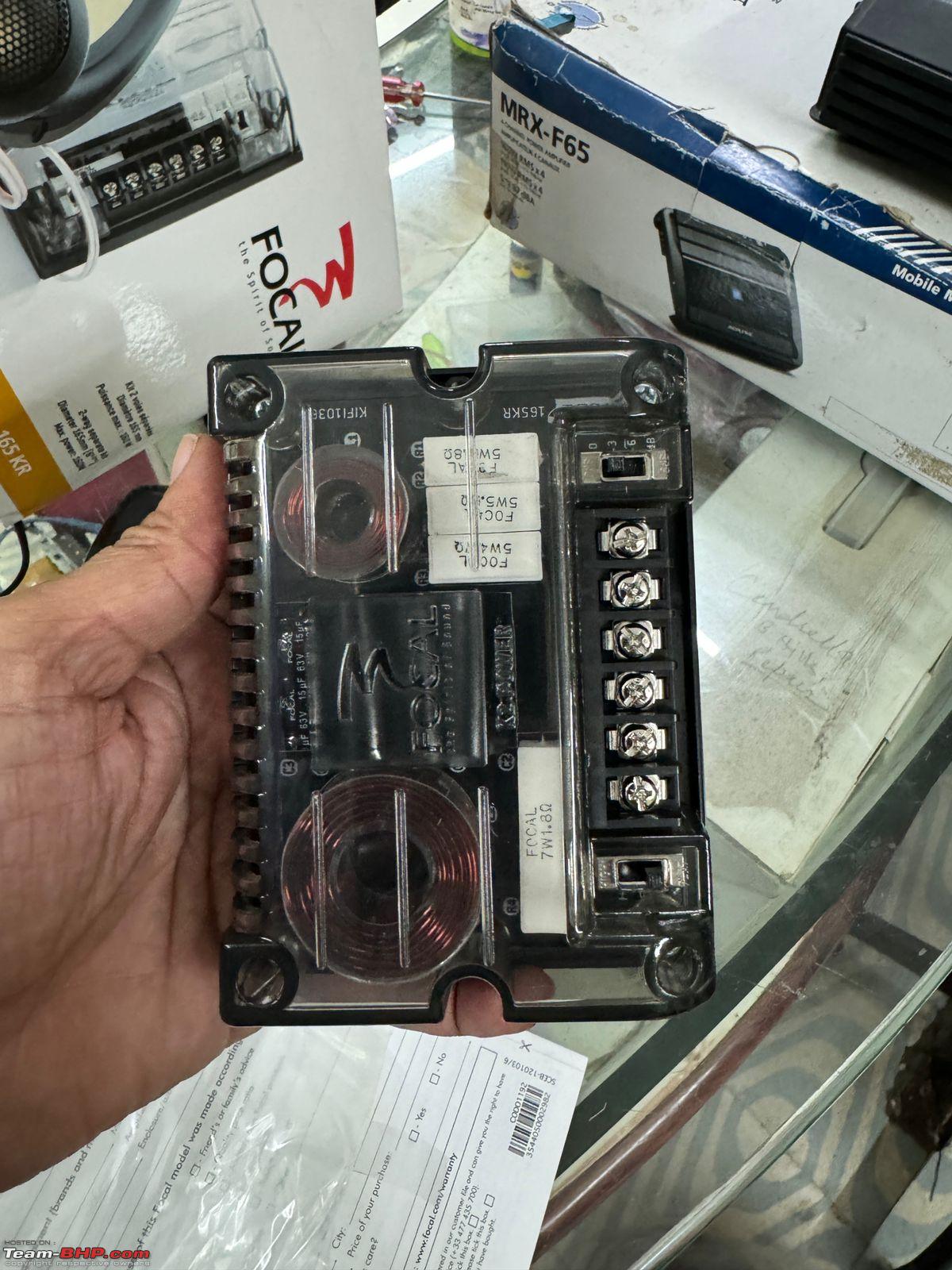

Upgraded the audio system in my Nissan Magnite | Component speakers, 2 amplifiers, subwoofer & DSP-whatsapp-image-20241014-4.12.41-pm.jpeg
Crossover

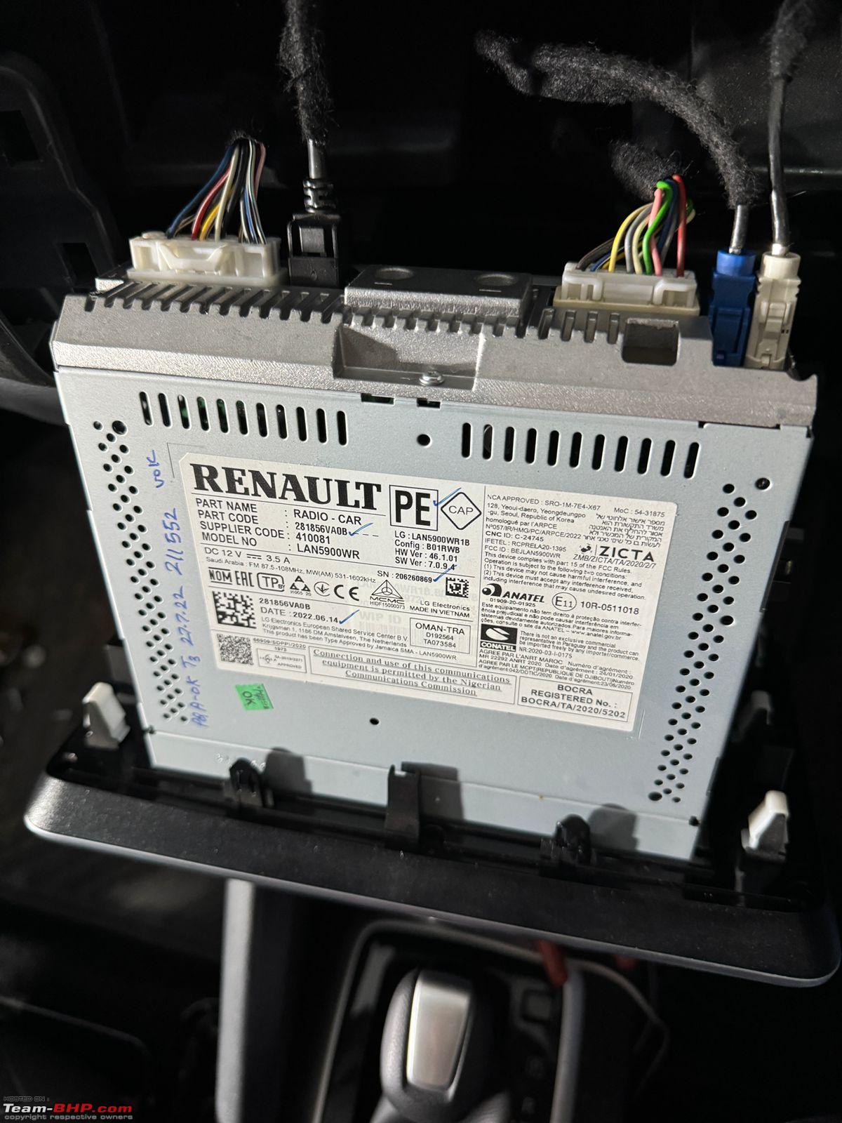

Upgraded the audio system in my Nissan Magnite | Component speakers, 2 amplifiers, subwoofer & DSP-whatsapp-image-20241014-4.12.45-pm-1.jpeg
I tried to get a good view of head unit's backside but couldn't as he didn't fully remove it. He connect the cables to the DSP from one of the sockets.

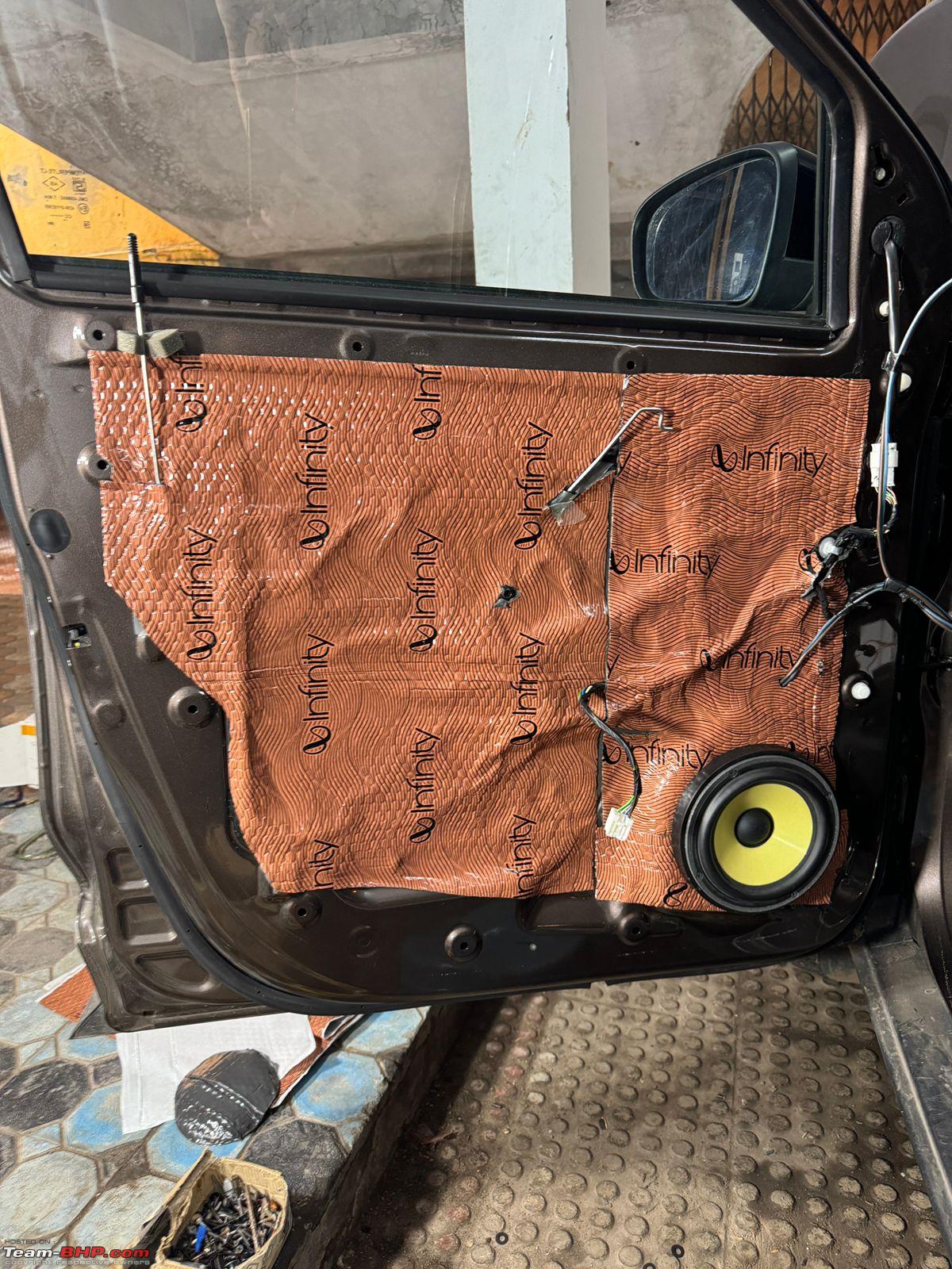

Upgraded the audio system in my Nissan Magnite | Component speakers, 2 amplifiers, subwoofer & DSP-whatsapp-image-20241014-4.12.45-pm.jpeg
Used infinity door damping material. The beautiful yellow coned Focal subwoofer can be seen.

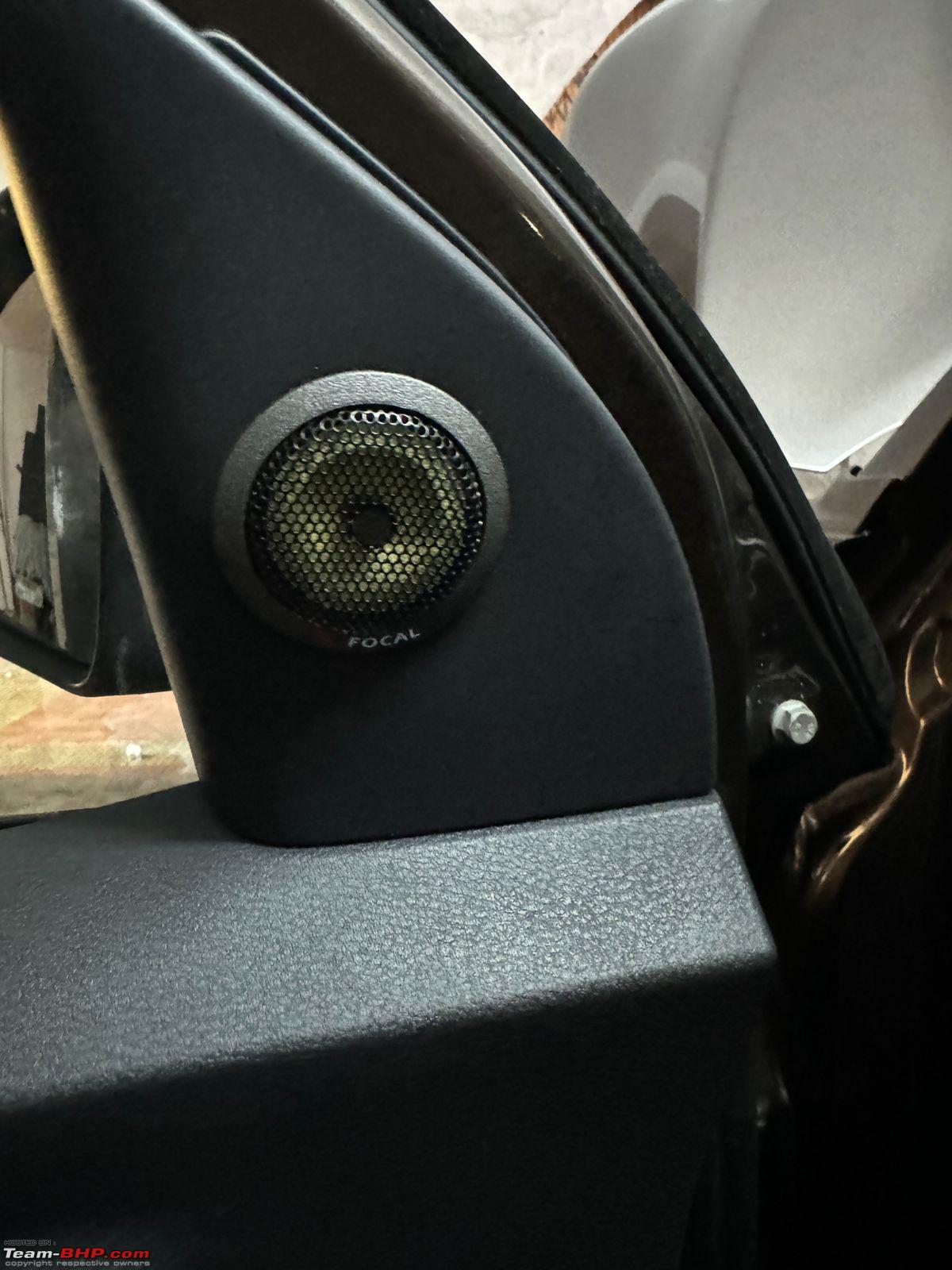

Placement of Tweeter.
Mr. Shakeer, Team BHP's go-to audio installer in Hyderabad, did a fantastic job with the installation and fine-tuning of the DSP.

It's a passive setup.
The head unit is connected to DSP bypassing the original connections that goes to the stock speakers. As you rightly pointed out, there are no pre-outs (line level outs) from the head unit, unfortunately. I wish it had so that I could avoid extra investment on DSP. But many audiophiles believe that DSP would do wonders even for a better after market head unit.
The DSP is connected to the 4 channel amp and the speakers wires are drawn from the amp. He configured the DSP using Rockford app through his tab. It took nearly a couple of hours to configure it. This makes me believe that not every technician can do this.

Originally Posted by vamsi.vadrevu View Post
A small query- did the sound damping improve NVH in any way? I'm asking because Magnite's NVH although tolerable could be improved and I was wondering if there's been a perceptible improvement to the NVH because of the damping.
Damping is a must when you go for high quality components and amp. I can say day and night difference was felt when he connected speakers and played the first song. Speakers are little tight for now, but once they burn in , they may sound more sweeter.
