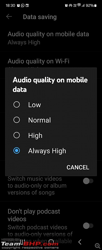

The 6GT has a great sound system, as do many cars today. In an entirely different segment, I am test-driving the Tata Curvv and loved its audio setup.
This is a topic close to my heart as I live on music; it's a part of every waking hour for me.
1. Open up your streaming apps, subscribe to the premium plan (subscriptions are cheap in India), and select "high quality" always. This is how my YouTube Music looks. This alone will significantly improve your SQ.
