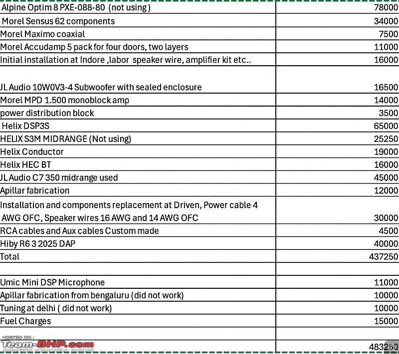

Originally Posted by autotranny (Post 5940720)
Very informative. Would you mind sharing the ball park costs of the equipment and the labor charges at these places.
It will also be worthwhile to share a couple of pics of the final install, the A pillar especially.
Below are the costs of different components and labor charges. Please note that I might have forgotten the exact figure, but this is to give a rough estimate.
