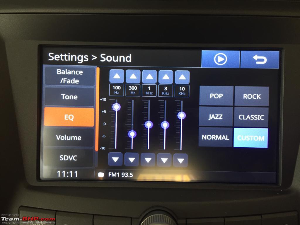

Old 2nd July 2019, 11:39   #43
Posts: 44
Thanked: 53 Times
Re: Rear Speakers Position: Door v/s Tray, and all that!
Then you should have looked at fitting the same brand of components. Now that you have the JBLs my best advice is that you consider using the equaliser settings on the head unit to reduce the high frequencies and boosting the mid-bass.
Thankyou so much for your suggestion. I tried to change EQ settings and have got excellent results so far. Earlier almost all frequencies were set to +8 level, resulting in average sound quality.
The present settings are exactly as per image.
The bass is way more than what it was, vocal clarity is excellent but I think I can fine tune it even better.Please guide me on how it can be improved further.
Rear Speakers Position: Door v/s Tray, and all that!-img20190702wa0002.jpg
praveear is offline
Old 2nd July 2019, 13:48   #44
navin's Avatar
Join Date: Mar 2004
Posts: 25,421
Thanked: 10,000 Times
Reduce the bass.
I would start with a flat response and then add or cut the 5 bands that you have by ear.
navin is offline
