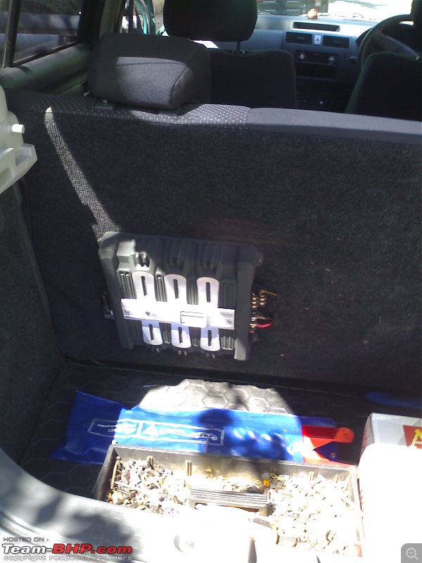

As promised, some pics...

The sub looks solid ! Have any pics of the finished install? wanna see how much of the boot is still left ..

Yup! The GT5-12 didn't have the '1200W' written. The GT5 - S12 has it though. Clearly mentions 'GT Series' on the sub
vibhu_f40: yup, a couple of pics coming up on the boot space
