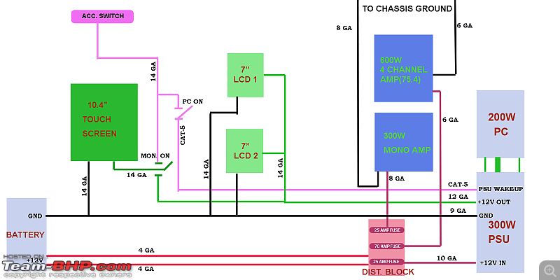

So here is my Power Diagram for my upcoming PC Project. Please help me to correct my mistakes:
Here is the big picture: http://img139.imageshack.us/img139/1331/ibmpc.png
