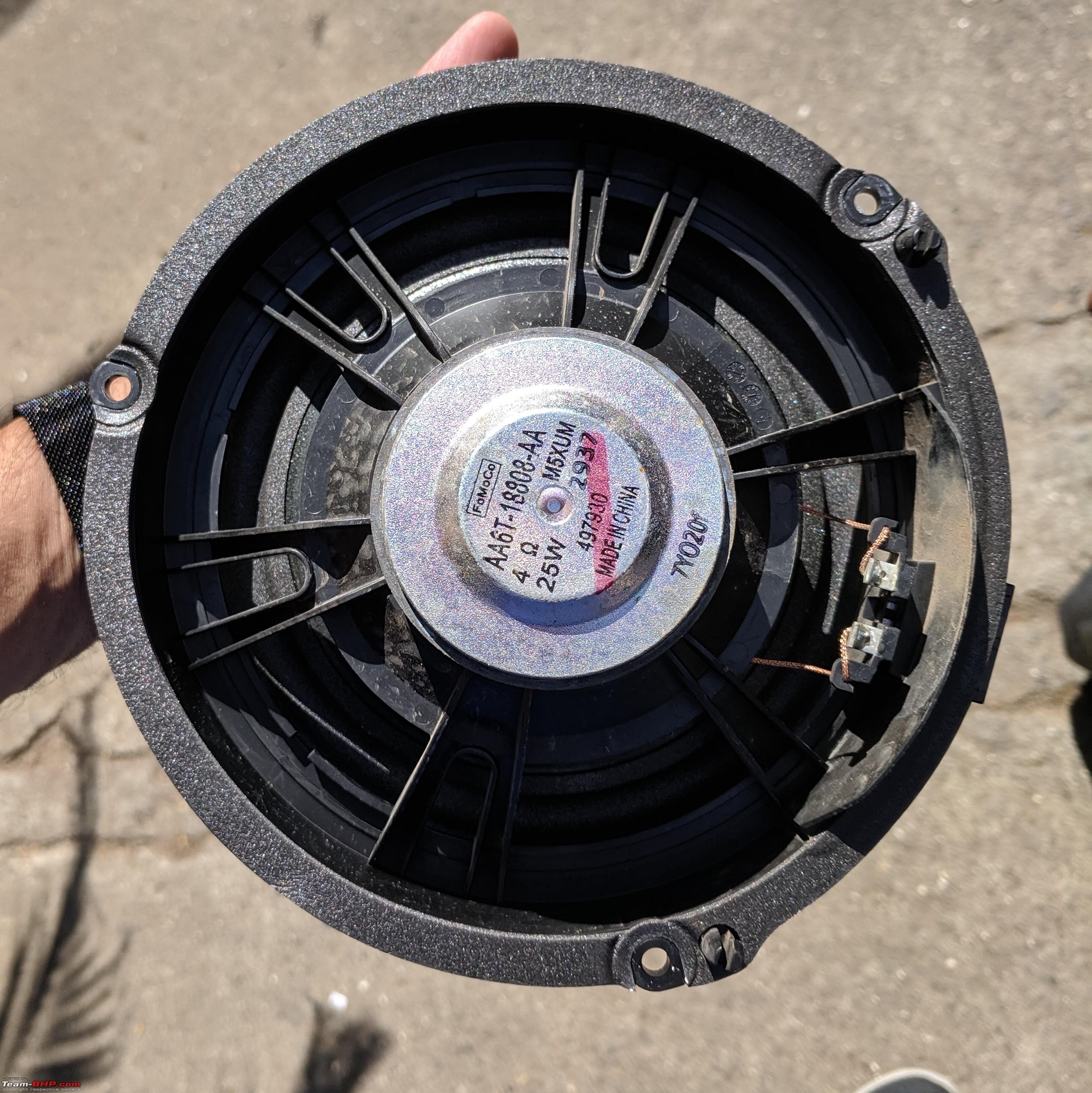

The high level inputs were taken from the front speakers in the door. No wires were cut and the wires were soldered on to the speaker terminals.

The stock speaker in EcoSport

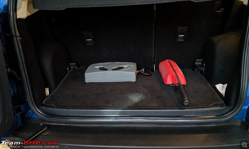

The sub placed in the boot of EcoSport.

With a Jopasu duster for reference. It's really small.
Car Audio Advice from the Audio Gurus: Use "Search thread" before posting a new Q!-img_20190513_191431.jpg
Hidden away under the false boot floor of EcoSport.

I thought under-seat subwoofers are designed to work better 'under the seat' rather than in the boot or elsewhere. BTW, did you try placing the subwoofer under the driver's seat and see how it performs as compared to it being placed in the boot?!
I may be wrong, sir, but just a thought and no offence.
Originally Posted by suku_patel_22 (Post 4604318)
It was his idea of placing the sub in the boot, as this will resonate well in the boot and sound better.
Originally Posted by a4anurag (Post 4604329)
I thought under-seat subwoofers are designed to work better 'under the seat' rather than in the boot or elsewhere..
For the frequencies that the sub will handle, How will position of the sub affect it ?
@Suku_Patel - how do you find the sound when driving ?
Originally Posted by condor (Post 4604342)
For the frequencies that the sub will handle, How will the position of the sub affect it?
My doubt was 'only' based on the 'subwoofer type' that it is advertised as - underseat. That's all.
Technically it may not make much of a difference where the placement is but the bass produced may not be properly felt when placed in the boot. Having it placed under the seat, it'll make its presence felt properly.:D
After listening to the sub in Santro, I was sold on the idea of placing it in the boot, hence didn't even try under the seat.
I wanted the bass to fill in and not overpower the sound and am happy with the way it sounds in the boot. Moreover moving it around should not be a big issue. I'll try it someday.
I also like the fact that the sub is hidden under the boot floor.
