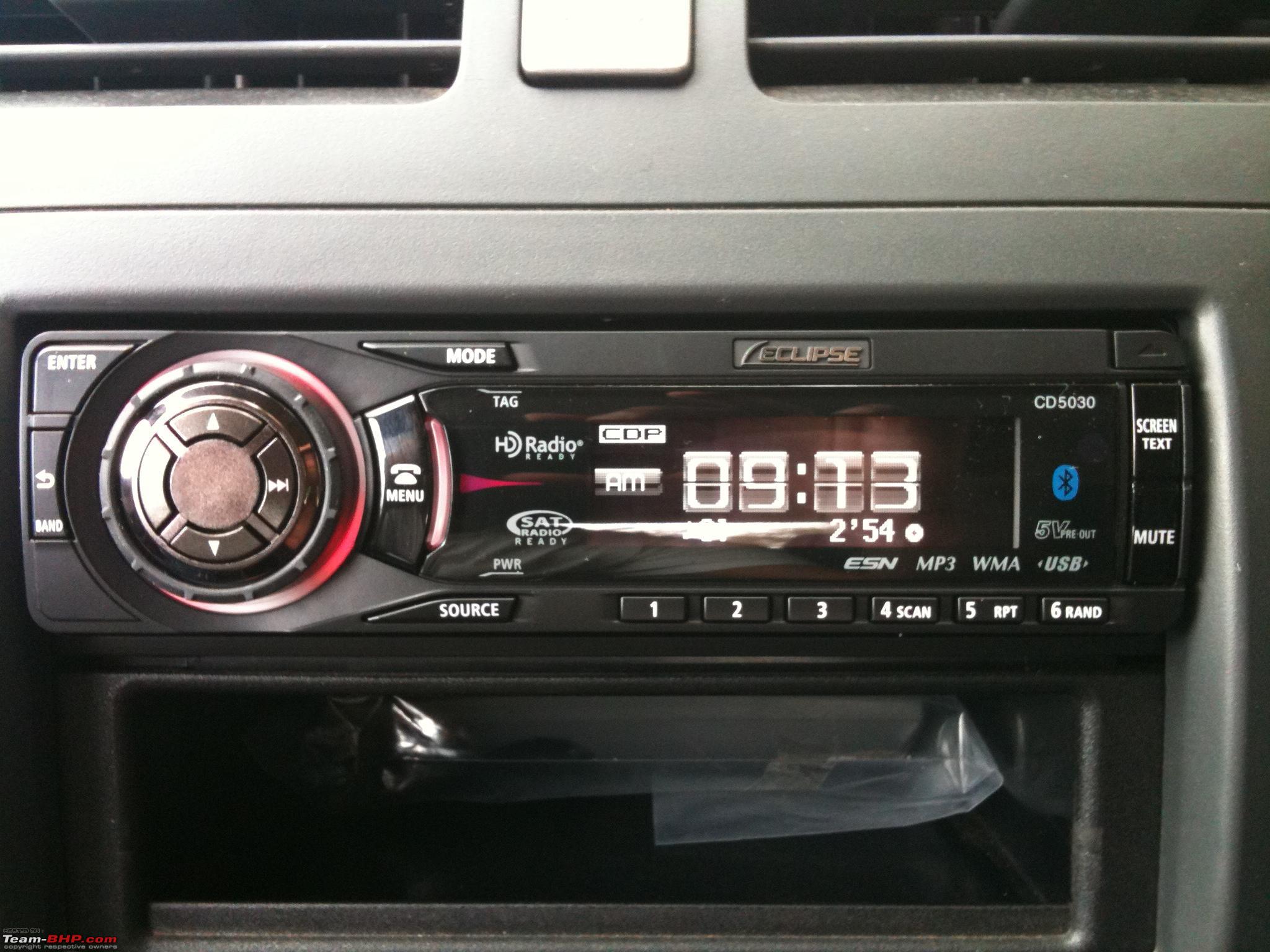

Its really difficult to guess the upgrade as it has made all my other gears such as the speakers and amp a bottleneck now.
First of all I went for damping on the front doors, which improved the mids and reduced a harshness a bit.
But the real deal is the picture below.
With this the Sub has disappeared and the imaging is spot on with couple of hours for tuning alone done along with Sathya.
I find the sound at any volume now to be mellow and not even a single bit harsh and changed the JBL GT5 component's character.
No pictures of the damping, but both the inner sheet metal and the doors were done with Accumat taking 5 sheets for the front 2 doors.

I drove 500 kms listening to the new Eclipse this weekend to get a good idea of what I am dealing with, before coming up with a review.
So here it goes.
I initially started my hunt with ubiquitous DXZ785USB, but couldnt find great deals on it. I could get only a best deal of around 180 - 190 USD. Hence I thought, lets go with the Kenwood X693. Realizing, why not go with its big brother X993 which is the same as X693 with the additional bluetooth module.
The competitors to the X993 at the price range where the Eclipse 5030 and the Alpine 9887. Alpine 9887 was ruled out as it needs additional modules to get iphone 3gs support and even then it is hit and miss.
X993 generally had great reviews across, and had very few limitations such as the lack of number buttons to select the preset tuning stations. It even has the ability to match the illumination to the car's illumination color. It has the usual midrange capabilities such as time alignment and PEQ (3 Band I guess) as well, but no auto TA, auto EQ.
I would have gone with the X993 but I was hesitant on the kenwood brand and hence went with the Eclipse which is supposed to be a better name
Coming to the Eclipse 5030, the difference in sound compared to the Sony GT670US is night and day, in my opinion. When we switched on the unit for the first time I was overwhelmed. Sathya on the other hand was not quite happy with the unit. He said the build quality compared to older Eclipses has gone down a bit, and the SQ compared to say 9887/7200 is not so good. But the other components in my car are the bottlenecks as I said in the earlier posts. And even the sealed box for my sub box is too big as per his view. I will have to change to a small box to get better Bass response in the near future.
Compared to the kenwood it has better audio tuning capabilities such as 7 band PEQ, Auto TA and Auto EQ. This needs an additional MEI100 mic to be hooked to the aux port. Once we start the auto tuning, it does a count down and allows us to get out of the car, while the HU does the TA by using pink/white noise. Same goes for the auto EQ as well. Sathya did one round of tuning himself, then we did the auto tuning and an additional round of manual tuning. The manual tuning involved measuring the distance between each speaker from the listening position and coming up with the time delay for each speaker. I had noted down the measurements, just in case, I accidentally change the settings in the future.
The TA/Auto EQ really helps, but of the 3 methods above, the manual tuning using the measuring tape and calculating the distance was the most I favoured. With this setting, the staging is right in front of the drivers seat and the subwoofer literally disappeared. Earlier, the sub and the mids were disjoint, and I could hear the sub firing from the back. Overall the SQ is excellent in my opinion comparable/better than most home setups I have heared. The sound is smooth and transformed the JBL GT5 into a midbass/midrange wonder from a high frequency torturers. With better speakers and amp the HU will better come to life in my opinion. But that is for a later review in the medium term when i go for the upgrades.
The usability of the HU is great with 2 illumination colors (Red, Blue). I liked the red color. The display is clear as well. It integrates well with my Iphone3GS, but there are some bugs in the iphone 3.0.1 OS that I am currently running causing some trouble. The controls are easy to use but not so easy to do when driving. The bluetooth audio is the best I have heard. I did half of my trip using the bluetooth audio connected to my iphone and the sound is good. When I switched back to the iphone cable option the sound significantly improved and the response is great.
With the 2 layers of damping I had done, the mids are kicking really well. The midbass is excellent compared to the non-existant mids earlier without the damping. But after doing the damping there are some rattling creeping up in the doors. Probably some wires are left loose when the door was opened to do the damping.
Only disappointment was the bluetooth phone option. It provides phone book option but it couldnt download the phonebook from my iphone or the MotoRazr phones. Also, the person on the other end, is not able to hear me very well, after trying various positions such as the visor for the supplied microphones. I had contacted Eclipse support and am awaiting response on this.
