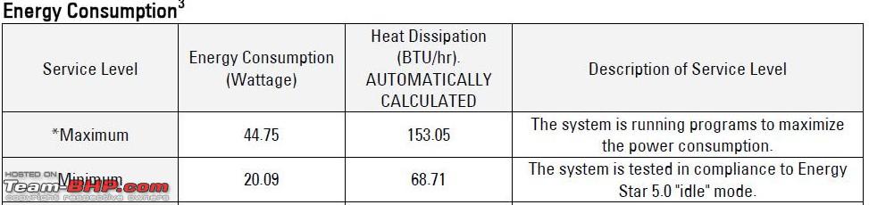

System Power Requirements

Originally Posted by greenhorn View Post
This needs a 20V DC supply, which makes it kinda hard
Wont a normal 12V to 220 AC Inverter do the job?
thats a bit of an inefficient/inelegant solution. ideally you're looking for a DC to DC solution
