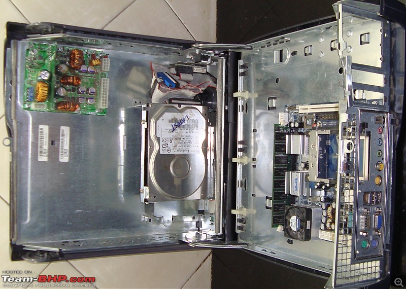

Thanks Ripper, This was the smallest cabinet available with an disk drive option. My car had no space under the seat & allot of space in the back this made me choose the Dell cabinet over the others.
I had to mark the holes for Motherboard screws & drilled them in the cabinet metal sheet. I am using the VIA 12000 EPIA MII-Series Mini-ITX Board. It was fitted in a way so that I can even add a PCI card as well if needed. Check the Pic1 for M.B. install.
I opened Opus SFX-1215 150W DC-DC Power Supply, mark the holes for screws & drilled for holder on other side of the cabinet. I am also powering my Lilliput 7" VGA screen from this P.S. Check the Making your monitor touch screen for Car PC http://www.team-bhp.com/forum/diy-do...en-car-pc.html
I am using a normal size hard disk drive as this cabinet has the option to use the 3.5"disk drive. Please check the Pic for complete install.
I am now facing issue with installing the Panasonic Blu-Ray drive in this cabinet. The laptop slim optical drive is too thin & cannot be used without any casing. If I install Blu-Ray drive with the UCB Casing it is very tight & the drive tray would not open. Although I have installed it with double tape, do not know for how long it would last. I was planning to install the cabinet behind the back seat.

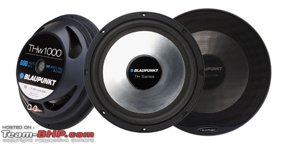

I have decided to use the Creative Audigy2 Pcmcia Card for Audio Output as i am not satisfied with the on board audio. Its 24-bit sound resolution and 7.1-channel audio output. I know there are plenty of good options available in PCI cards but I feel a PCI card would cause more issues than enhancing sound quality. On the other hand Creative has optical in & out, I am sure if I can find an Car Amplifier with Optical Input it would sound the best 5.1 as optical cables pass the least distortion. Suggestions are welcome from the experts.
Meanwhile I am thinking of using the Blaupunkt THA555, It is an 5/4/3 Channel 840 Watt Power Amplifier - With Maximum Power: 4 x 110 watts + 1 x 400 watts. Would power two BLAUPUNKT THW1000 10" SUB-WOOFER. They are aluminum skin saucer with extremely low weight and mounting depth of just 2.5". Hence they can easily be mounted anywhere. The
Power Handling is 200RMS, Peak Power Handling 600Watt. Lets see how rest of the setup goes this weekend .
