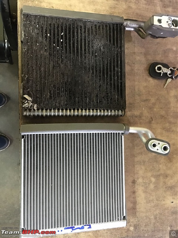

Curious to know how the old coil looked like.
Could you post pictures of the old and new evaporators?

Attached. There was an oil stain on one side of the old evaporator, though not much dirt.

That's the coil of my friend's Civic, replaced at the same place after mine was. Posted by mistake. Here's my old coil.
