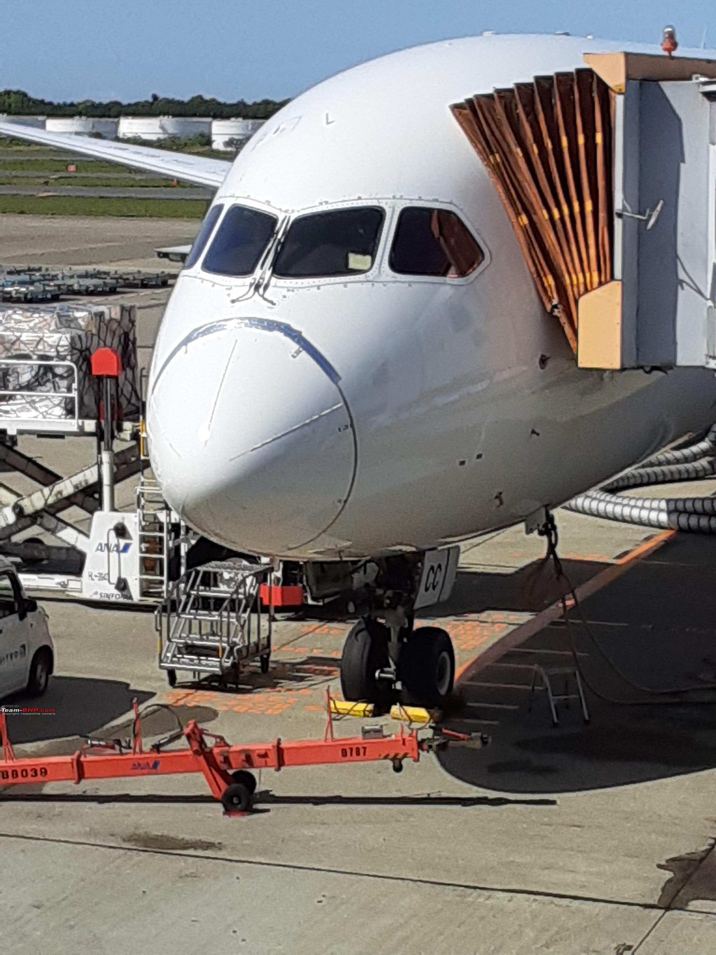

Even though it is about the 787, I am posting it for here as there is a healthy technical discussion regarding air planes on this thread.
Please see the photo.
The nose cone seems to be held by a duct tape.
What type of duct tape is it?
Is it to prevent water seepage inside as there is housed a radar behind that nose cone.?
What kind of glue will the duct tape use, as it should over come about -70 deg C, wind force and then tropical heat.?

What we are seeing is a heavy-duty aluminium bonding tape known as ‘speed tape’. It’s a temporary fix and it’s used only on superficial or noncritical components, or non-load bearing components until more complete repairs are made later on typically when the aircraft reaches its home port some hours later. In some geographies it is called the Jesus tape because it saves your backside!
It is approved for use by the Federal Aviation Administration (FAA), and engineered to adhere to the airplane fuselage, even when traveling at 550 knots (over ~1000 kmph) the typical maximum cruising speed of an airliner. A roll (can’t recall the length) costs around Rs 50,000 a piece. And of course it can withstand the cold temperatures and lower air pressure of 40,000 feet.
In the case here it is probably being used to hold together a thin crack which it can well do as the nose radome is quite light. If it went all the way around over 180 degrees then it could be also for waterproofing but that may not be the case here. Typically these band aid fixes are made when the airliner is away from its home base and the repair is not life threatening. But I will comment, like an old grouch, that they could have laid it out more neatly.

Many thanks Narayan sir.
Any idea of the bonding material of the tape, that would be interesting.
Also any automotive equivalent for us.

Sorry no idea any longer. Maybe at some earlier point I might have known. But as my brain has shrunk with age it is one of those pieces of information that got filtered out
