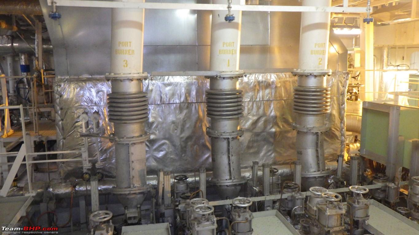

The working of a Marine Steam Turbine onboard a Merchant ship-rs-port-burner.jpg
PORT Boiler Burner
