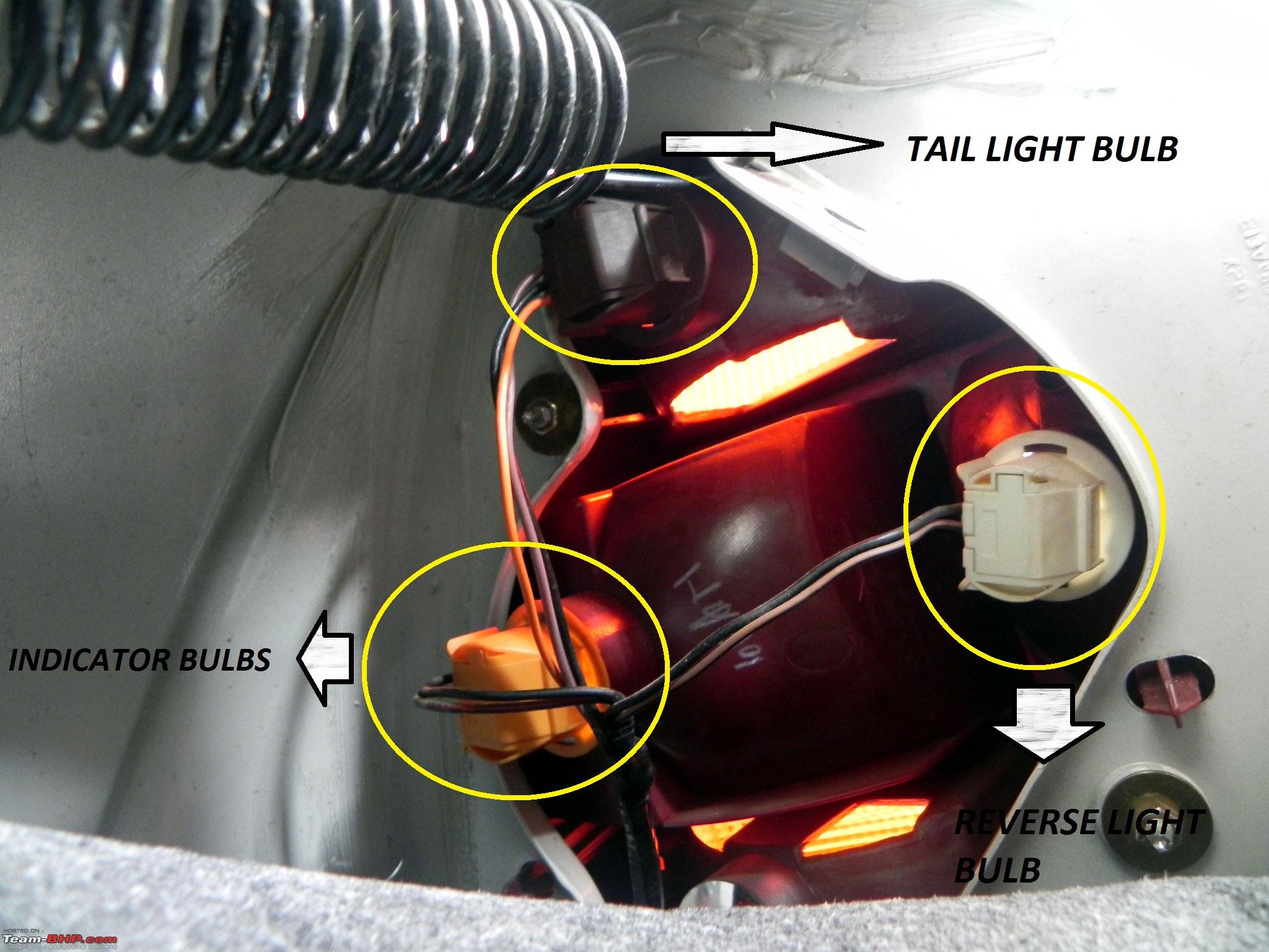

TAIL LAMP CLUSTER AND BULBS.

Step 3: Remove the bulb holders. For removing the bulb holders from their seating is pretty much simple, and is the regular 'twist-pull'.
A List of DIY's for your car: A Pictorial Guide-diy-tail-light-replace-remove-holder.jpg

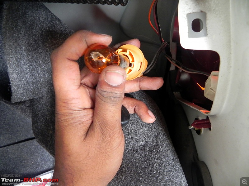

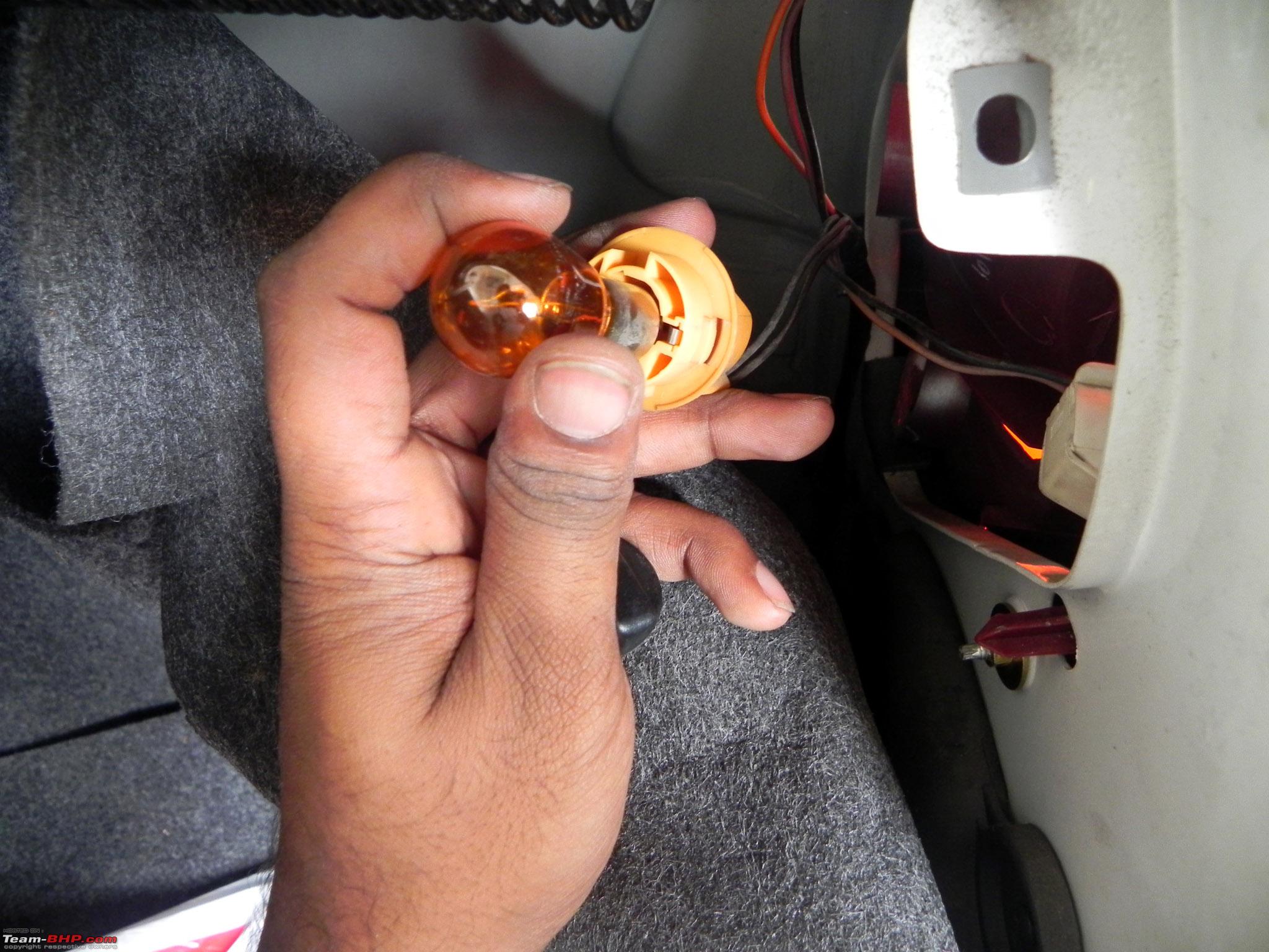

Step 4: Replace the bulbs. Again, removing the bulbs too, are pretty easy, as they are the regular - twist-to-remove type.
A List of DIY's for your car: A Pictorial Guide-diy-tail-light-replace-replace-bulb-twist-pull.jpg

THINGS TO CONSIDER: While replacing the tail lamps, which are two-in-one bulbs, please check if the correct bulb(brightness) glows for brakes and parking lights. If they seem to be reversed, ie, while bright ones for park lights, then remove the bulb and fit in the reverse direction.
