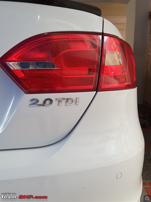

Did this process on my 8 year old Jetta. The results are wonderful. Thanks a ton for this!
Posting before and after pictures.

Outstanding!! It looks all new now
rajandroid is offline   (1) Thanks

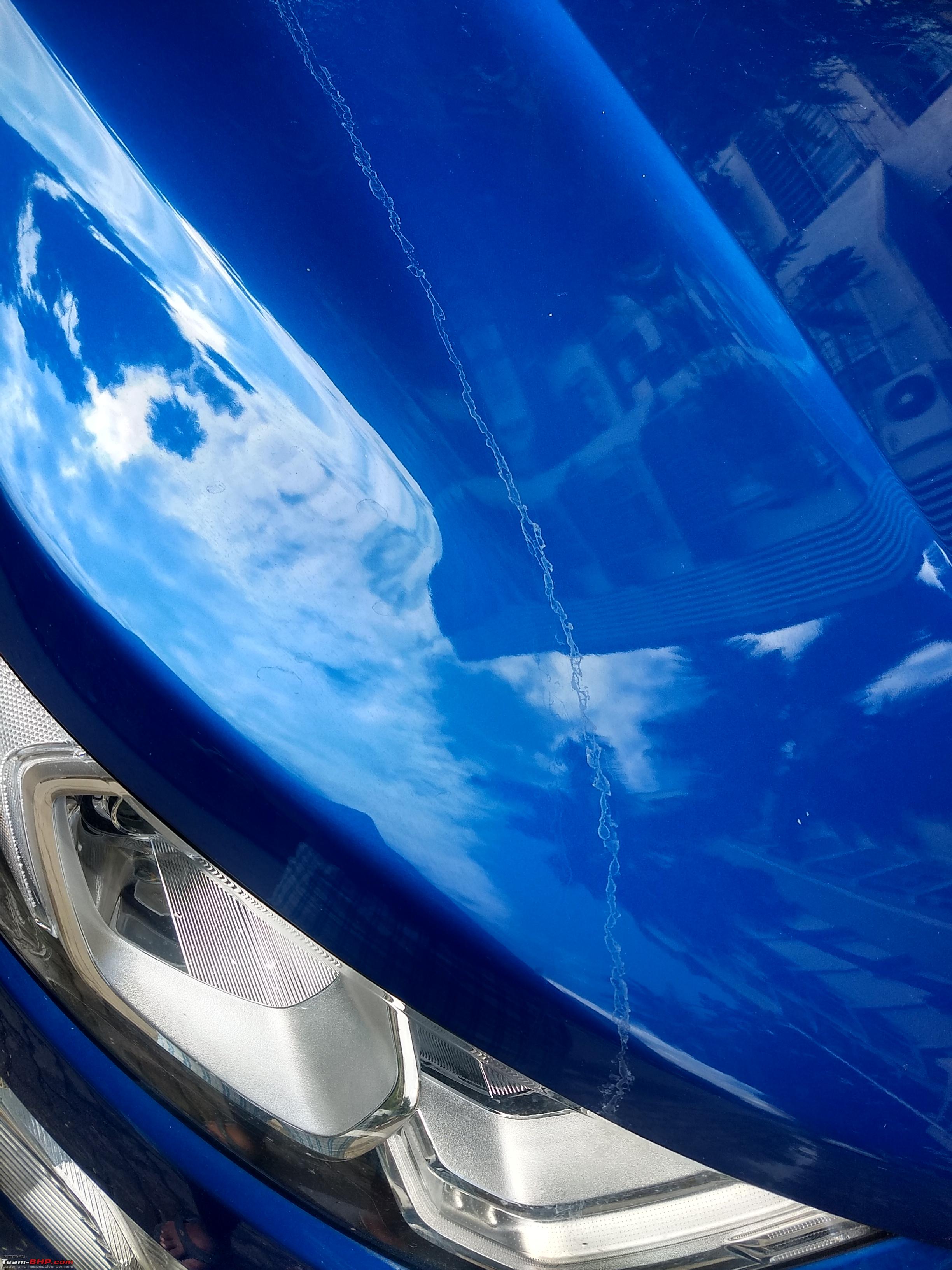

Got these hard water marks on my Blue Ecosport.
Any suggestions to remove them safely?
The options that seem promising are:
1. Lemon+Tamarind combo
2. Colgate
Any other ideas? I've got the 3M Car Shampoo. Could that be of any help?
