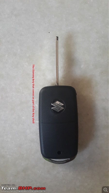

Was always wondering if I can get my regular keys converted to a flippy key one along with the remote button functionality.
Lurked on this thread for a while flipping pages and realized it was an easy task.
Ordered one from ebay and managed to successfully convert the regular key into a flippy key!
Here are a few snaps from the DIY:

What I spent?
Flip key Shell via ebay - 999/-
Key Making charges 150/-

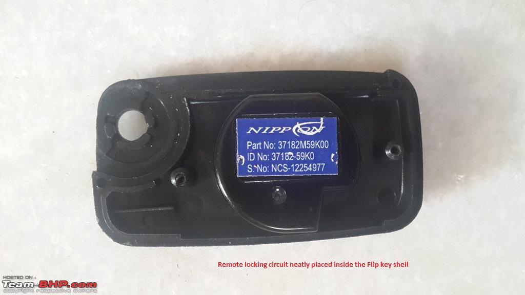

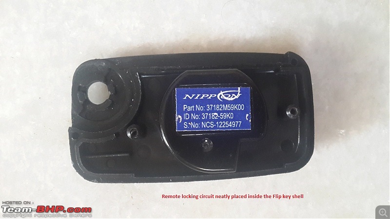

I paid 1800 for the flippy key unit + 400 for the key duplication. I was told that a Honda key is complex and therefore costs more to duplicate than other keys.
My original key was opened (the body was broken anyway) and the entire unit with the switches fitted into the flippy key unit. So now when the flippy key switches are pressed, they are actually in turn pressing the original switches inside.

Advise: Don't fit the remote circuit and transponder chip inside the shell and go to the key maker. Instead, go to the key maker first with only the dummy key blade provided as part of the shell along with your original key, get it duplicated and come back home and start assembling things inside the shell.
This will make things easy for the key maker to hold the dummy key blade on firmly.

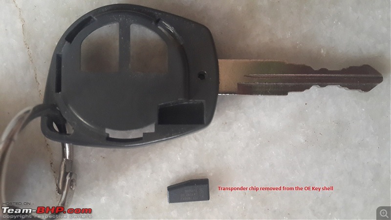

Can you post a pic of the transponder placed inside the new key fob, if you have. Where and how it was placed? Does it have a dedicated slot?
Here is the pic of the Transponder chip taken out from the OE key as well as the slot on the key fob where it fits. Make sure to wrap the transponder key with some thin paper like material/Tissue paper so that it fits into the slot in a secured manner.

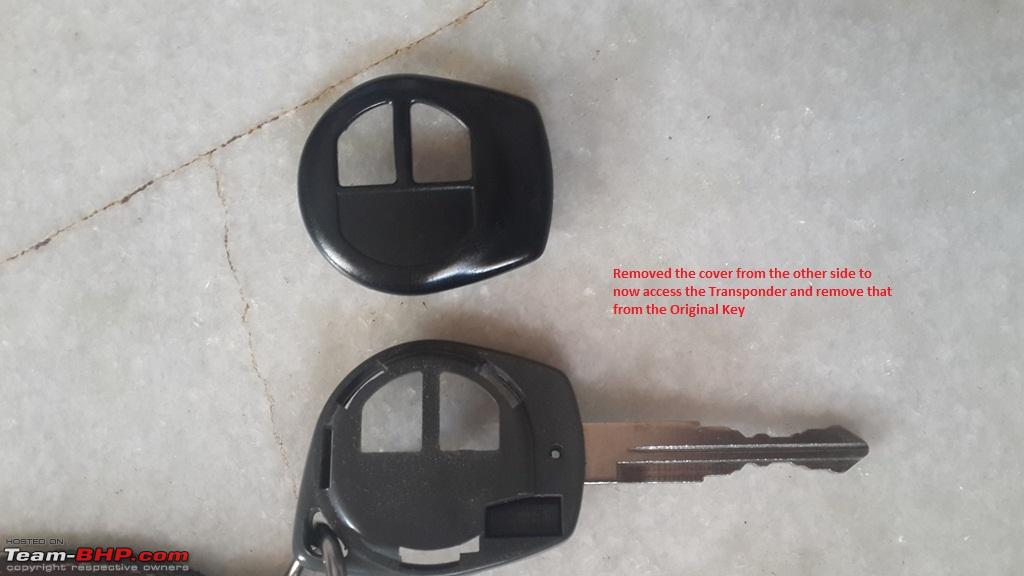

Transponder Chip:
When you open the OE Key after loosening the screw, you will remove the black cap that covers the 2 Buttons for lock/unlock.
This side of the key will allow you access to remove the Button circuit which is of the size of a coin.
However, the transponder chip is located on the other side of the key and you need to remove the black cap on the opposite side using a paper knife and pressing the clips and pulling the cap out on the other side.
Again, the transponder is placed in the OE Key with very little place around to insert anything thick. Use a paper cutter's edge and pull the transponder out.
The above two pictures will give you an idea on what I am referring to.
Also, check my post on the previous page where I have included all details (but do watch the Youtube video which has everything represented the way I described)

Essentially, the flipkey shell should be able to accommodate 2 things precisely and that should require no workaround in any manner:
1. The remote Button circuit
2. The Transponder chip
