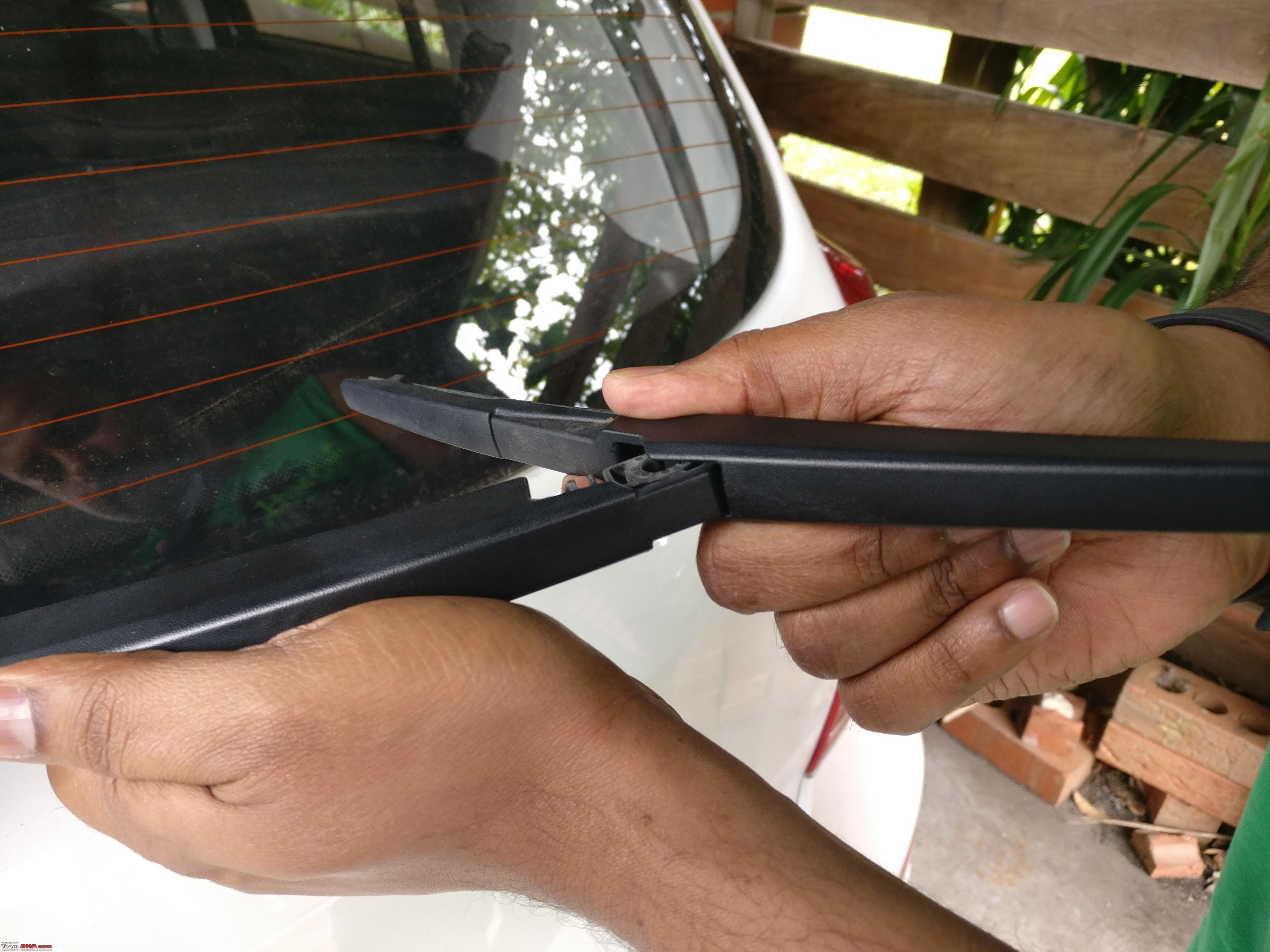

Hi folks, this is my first contribution, please excuse any errors or mistakes. Moderators please feel free to move the topic to a different thread if required. Decided to post here as this tread already has information on how to fix Hyundai i20 wiper arm.
Had gone out shopping and came back to see the rear wiper hanging loose like this.
Hyundai i20 DIY: Replacing the rear wiper arm and cabin filter-1.jpg
I looked around online and was unable to find much information on how to fix up the broken wiper arm. Did more googling and checked how the wiper arm was assembled on some other cars and took the plunge to fix the broken wiper arm. In a few easy steps i have described how replacement / repair can be carried out.
Step 1: Dislodge the wiper blade assembly from the wiper arm by pulling the wiper blade as shown. It is a press fit and will come out when pulled at an angle.
Hyundai i20 DIY: Replacing the rear wiper arm and cabin filter-2.jpg
Hyundai i20 DIY: Replacing the rear wiper arm and cabin filter-3.jpg
Step 2: Remove the protection cap which is at the base of the wiper arm, this cap is again a press fit.
Hyundai i20 DIY: Replacing the rear wiper arm and cabin filter-4.jpg
The exposed wiper arm without the cap looks like this.
Hyundai i20 DIY: Replacing the rear wiper arm and cabin filter-5.jpg
The wiper arm can be removed completely by unlocking the nut.
Hyundai i20 DIY: Replacing the rear wiper arm and cabin filter-6.jpg
In my case the nut was loose and i had to tighten the nut.
Hyundai i20 DIY: Replacing the rear wiper arm and cabin filter-7.jpg
Press fit the protection cap. The wiper blade assembly again has to be assembled by pressing the wiper blade at an angle and it will lock into the assembly. Please ensure that the locking has taken place.
