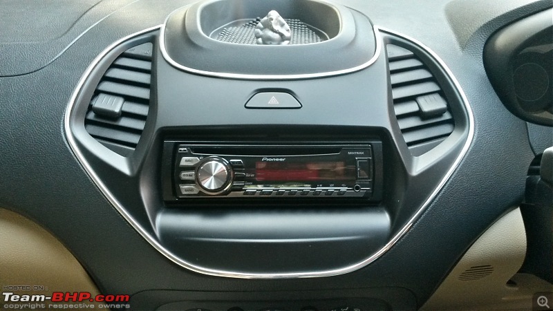

AC Vent - Before:
DIY: Chrome highlights for the interiors-ac-vent-old.jpg
AC Vent - After:
DIY: Chrome highlights for the interiors-ac-vent1-chrome.jpg
DIY: Chrome highlights for the interiors-ac-vent2-chrome.jpg

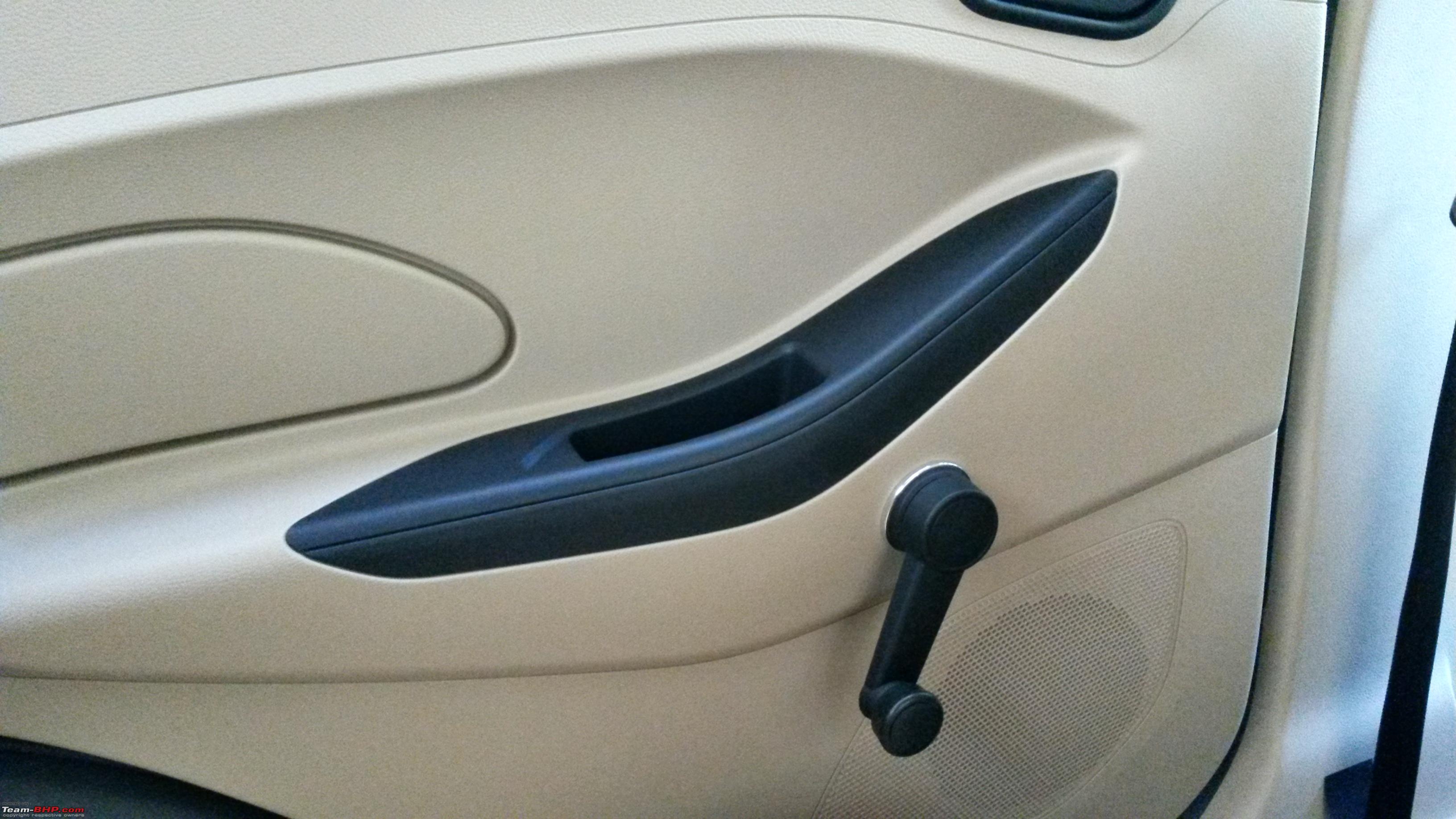

Window Roller - Before:
DIY: Chrome highlights for the interiors-roller-old.jpg
Window Roller - After:
DIY: Chrome highlights for the interiors-roller-chrome1.jpg
DIY: Chrome highlights for the interiors-roller-chrome2.jpg
PROBLEM AREA: For circular areas where 2 ends of the chrome strip meet there is a problem - the joint will not be clean as seen below:
Vent with original chrome:
DIY: Chrome highlights for the interiors-chrome-org.jpg
Vent with stick-on chrome:
DIY: Chrome highlights for the interiors-chrome-fault.jpg
