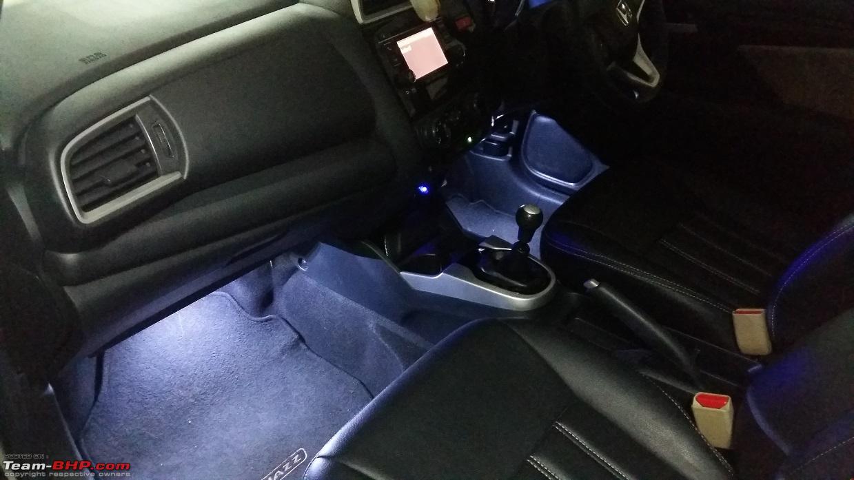

Completed on Jazz
DIY: LED Footwell Lights & Cabin Lamp for the Nissan Sunny-20170111_170047.jpg
Looks bluish in this snap, but pure white at actual.

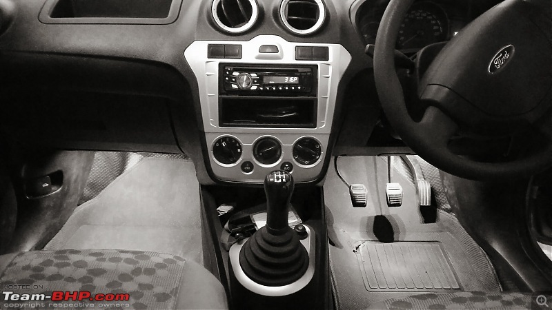

Installed on Figo few minutes back
DIY: LED Footwell Lights & Cabin Lamp for the Nissan Sunny-edited_20170112_151728.jpg
