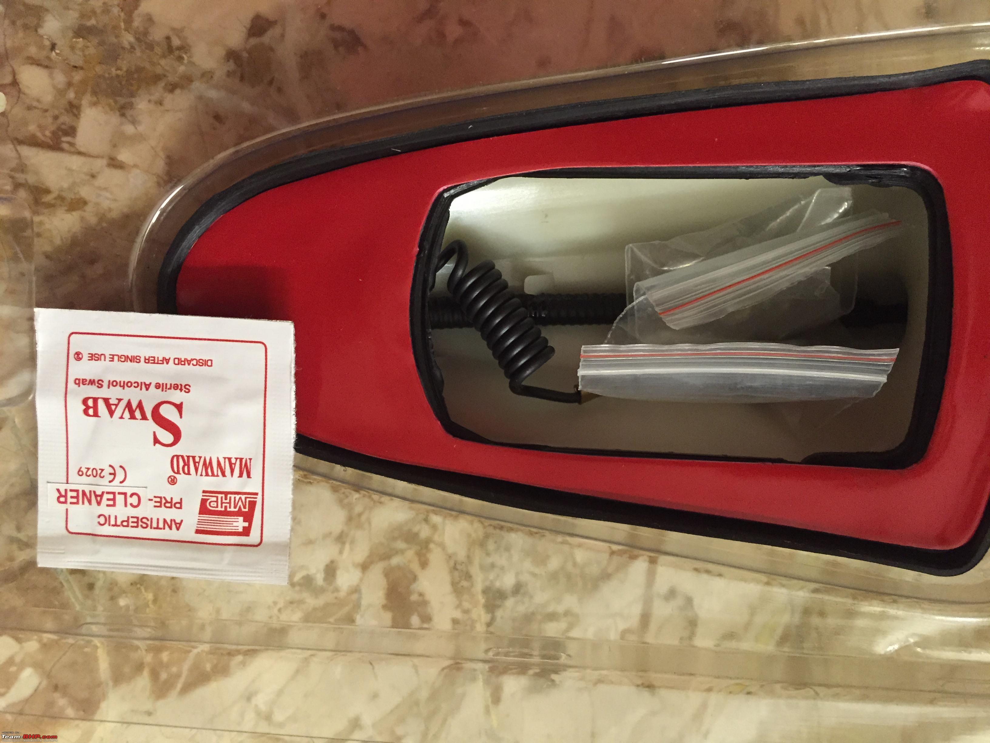

Inside contents:-
DIY: Shark fin antenna install on my Hyundai Grand i10-5.jpg
