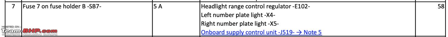

Reviving an old thread to share a tweak I did on this mod.
I have been procuring W8 caddy for our customers and always referred to this thread to follow the instructions and tap PIN 17 on headlight switch for the ambience light however was always scared that someone might end up splicing the wire incorrectly and may put blame on us.
Polo 6R Fuse Layout:
VW Polo DIY: Upgrading the Front Dome Light-screen-shot-20220227-1.58.24-pm.png
Research onto my car and realized that fuse no. 7 can also be used to do the job as this fuse is responsible for controlling lots of lights which turns on only after headlight knob is turned to either parking or lights on side.
Powering the Passat W8 Ambience Light through fusebox
VW Polo DIY: Upgrading the Front Dome Light-122.png
Last edited by Gannu_1 : 8th March 2022 at 11:15. Reason: Replaced the fusebox layout (your company's watermarks).
durvient is offline   (1) Thanks
Attachment 2281729
Great!
Did you use a Fuse Tap to do the job? Can you share how you connected the wire into the fuse? A pic would also add wonders to the ease of understanding.
Thanks in advance.
