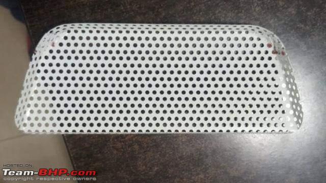

A strong stainless steel mesh, cut to dimensions and cleanly installed using body sealant is a much better option IMO. This is how they do it here:
DIY: Rat-proofing the A/C intake-20190529_021635.jpg
Also one of my friends had shared this pic, not sure if this is a Maruti approved accessory, but the idea remains the same.

1. The steel mesh might not be available as an accessory from Maruti. What you can do is approach any hardware store and get some good quality stainless steel mesh. A 4 sq.ft mesh should suffice for all your needs.
2. I'd also advise getting a rattle can paint spray and painting the mesh before installation.
3. Cut the mesh as per your needs and stick using body sealant.
4. Remove all your existing stuffed items like steel wool and scotch brite. They can go inside and clog the cooling coil badly. Also check if your waggy has a pre-installed air filter. If not, get it installed immediately.
5. I wouldn't recommend purchasing the body sealant since you'll barely use 10% and rest of the cartridge contents would dry. Also you'll need a caulk gun to use the sealant. Instead, just purchase the steel mesh, paint it, and approach your workshop's bodyshop. Let them cut the mesh as per needed dimensions and they also have the body sealant.

Thanks to your input and ideas I got a decent job done at ABT during my first 1000km service.
I think this will work.
