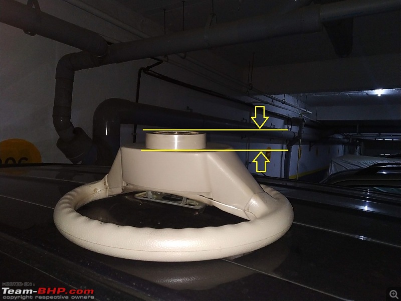

Checking if the steering wheel fits well:
This was a crucial step too and if this failed, the DIY would probably be abandoned midway. I was confident since I had researched so much that it will fit and I wasn’t disappointed. The steering was a precise fit on top of the contact coil (you can see the coupler in the top center), from every angle and in every direction:
DIY: Steering-Mounted Audio & Bluetooth Controls (1st-Gen Ertiga)-14-steering-wheel-fitting-contact-coil-check-01.jpg
DIY: Steering-Mounted Audio & Bluetooth Controls (1st-Gen Ertiga)-14-steering-wheel-fitting-contact-coil-check-2.jpg
Interestingly, the OE steering without airbags has some extra construction below it which otherwise is occupied by a contact coil in higher variants:
DIY: Steering-Mounted Audio & Bluetooth Controls (1st-Gen Ertiga)-14-what-occupies-space-column.jpg

Steering Centering:
Basement was perhaps the wrong choice to assess the center position of the steering and hence I ventured out along with the rachet and 17mm socket onto a proper road. I drove the car on straight levelled road for over a kilometer carefully observing the steering position. I realized that it was fitted few notches to the right and that it had to be removed and fixed back 2 notches towards the left to the final position.
DIY: Steering-Mounted Audio & Bluetooth Controls (1st-Gen Ertiga)-34-steering-centering.jpg
