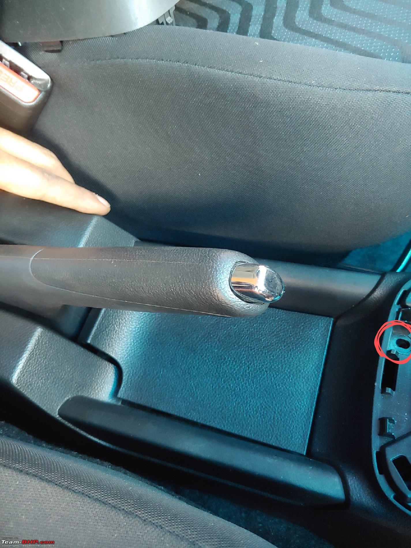

Now sit back. Remove the shiny Philips head screw that was supposed to be in that red circle. Sorry, I forgot to take a picture before removing it.
DIY: Maruti Swift center console removal guide-20201227_153334_resize_762.jpg
