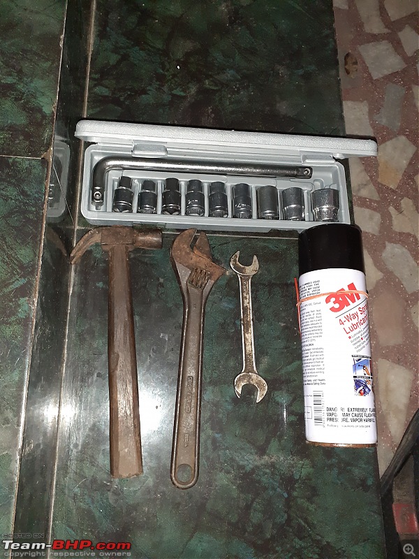

Shown below is the set of tools and an aid that I had with me for this task, and at the end of the task I realized this was almost all I needed apart from some cotton cloth waste to handle that grime and a Crowbar which I had used to get some thrust while removing and fixing the link rod into its groove.

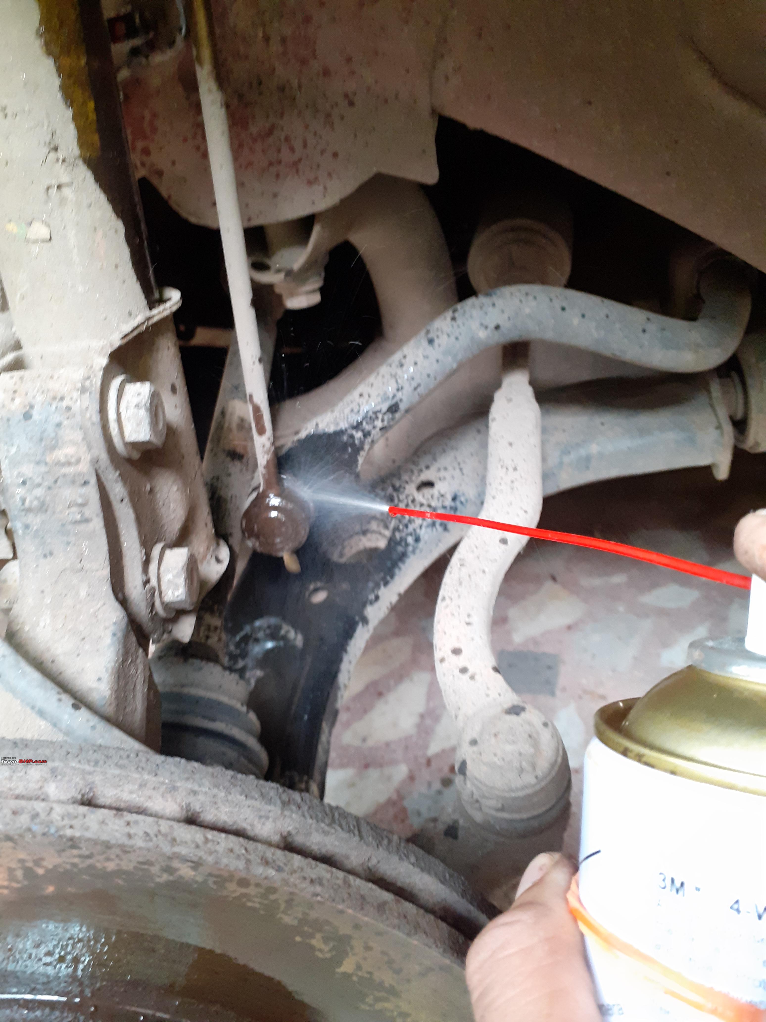

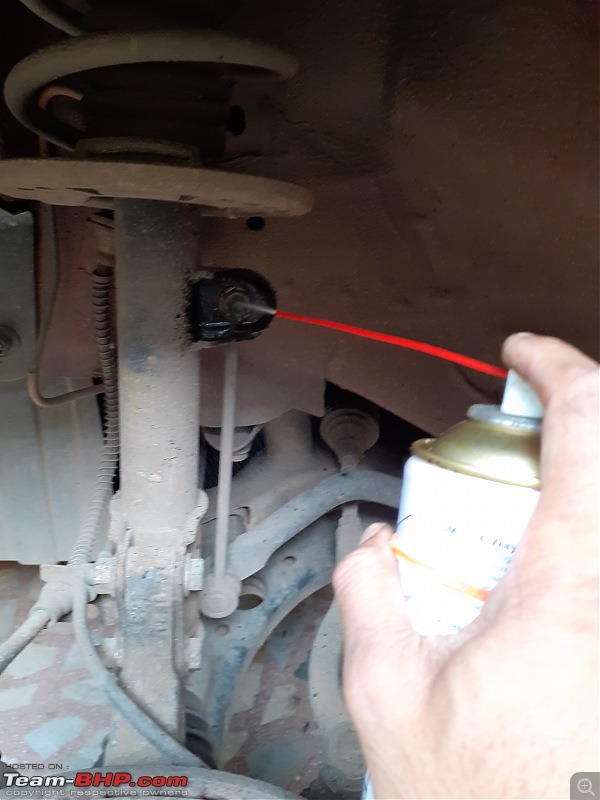

Now reaching the link rod was simple, first I had to get the car on the jack, and remove the front tire, in my case the left one and locating the link rod; see the pictures below.

The link rod was secured on 2 nuts, one on the top to the vehicle suspension and other on the sway bar at the bottom, both were of metric 17mm size, having a socket spanner helped me remove the nut on the top and facing outside. To access the bottom nut, I used a simple open end spanner as there was no space for my socket wrench to get in. Before I could get the wrench to work, I sprayed copious amounts of rust penetrant on both the nuts to make my life easy.

Once the nuts were loosened and pulled out, I had to use my crowbar to nudge the sway bar a bit to free up the bolts. The same story repeated when I had to insert the new link rod into its groove, without this its almost impossible to get the bolts to come off or get in the groove as else they would remain stressed from the torsion exerted by the sway bar; another easy trick I realized was to lift the front control arm a bit off the floor, that would be lot easy if you used a secondary screw jack. In my case the crow bar just worked fine.
