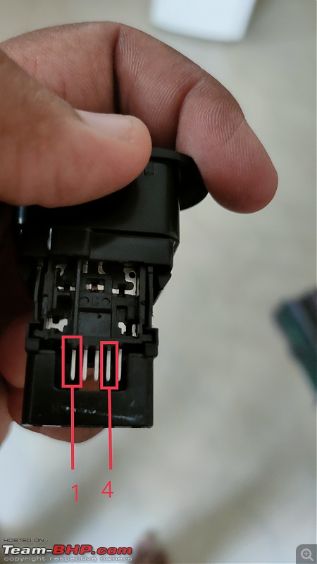

So here's how you perform the mod.

2. Pull the switch out, this can be done by removing the fuse cover on the side and popping the dummy cover after which simply insert a finger inside the dummy port and push the Start/Stop switch out from the inside.
3. Short wires 1 and 4, sharing pictures of the switch for better clarity;
DIY: Disabling Mahindra's Micro-Hybrid (idling start/stop system) for good!-img_20210704_082502.jpg
This is what it would look like after you've shorted the wires with a jumper wire.
DIY: Disabling Mahindra's Micro-Hybrid (idling start/stop system) for good!-img20210703140015.jpg
DIY: Disabling Mahindra's Micro-Hybrid (idling start/stop system) for good!-img20210703140017.jpg
Once done simply tape it up and you're good to go.
If you have a spare dummy cover then good enough or if you don't then use the switch itself, I fixed it back upside down just for a gag.
