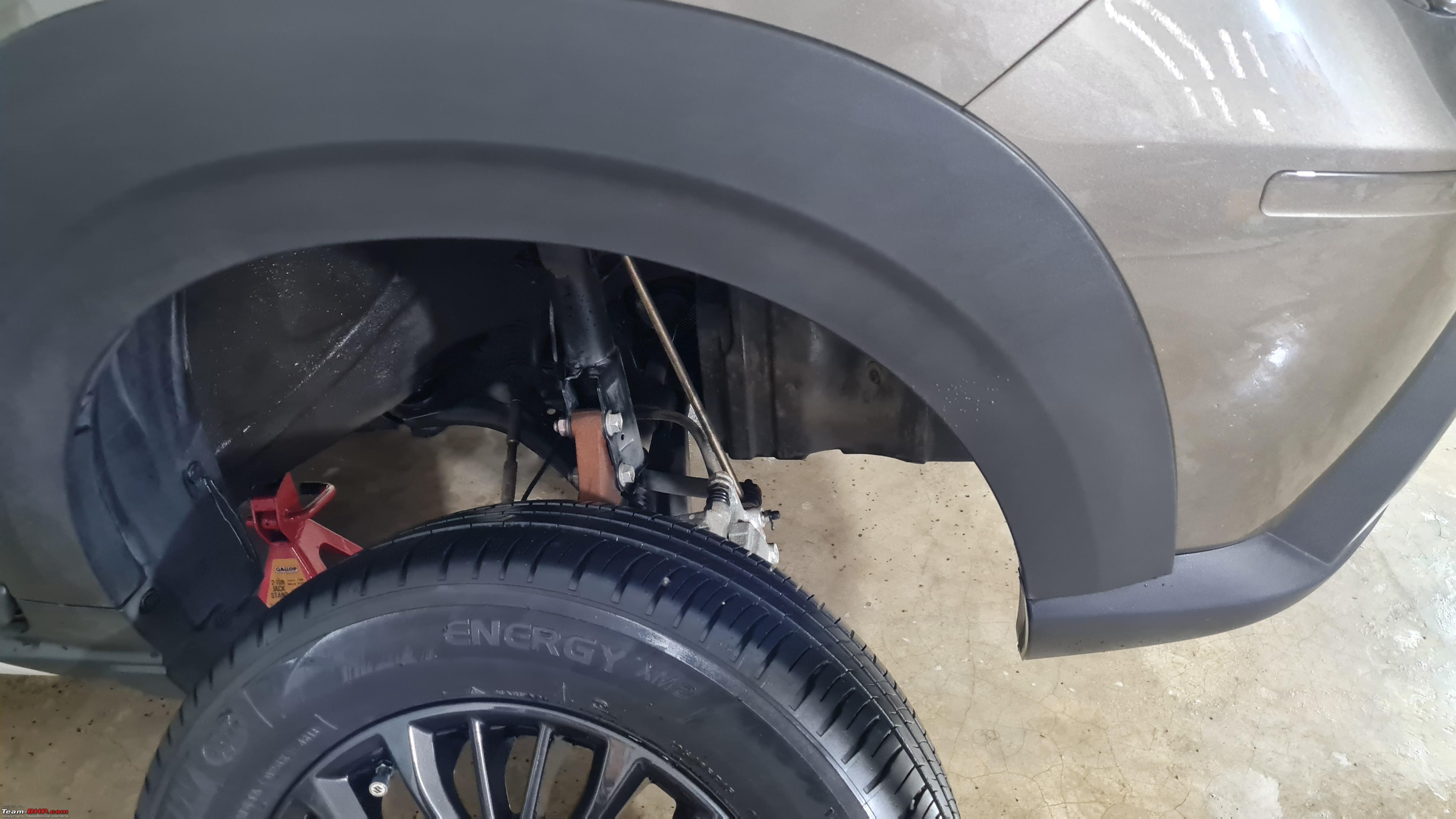

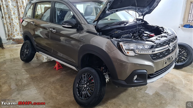

PS: In some other news, the XL6 is due for some TLC. Have removed the wheels for Rotation and brakes cleaning. Also intend to wash and detail it thoroughly along with a possible oil change(haven't really inspected the condition of oil yet). Earlier I was determined to follow 5k oil change intervals, but will check condition of oil before taking a call. It looked fine around the 14k km mark, but since then the car has done only heavy traffic runs within the city. So oil may have deteriorated.
Utilized the weekend to carry out these jobs:
1. Engine oil change, cleaning air filter
2. Thorough wash and detailing the car
3. 5 Wheel rotation
4. Comprehensive brakes cleaning, and switch to Toyota's grease.

The alloys were insanely dirty with lots of Tar deposits:
DIY: Servicing my Maruti XL6 myself-20211003_120905.jpg
Comprehensive washing:
DIY: Servicing my Maruti XL6 myself-20211003_125028.jpg
DIY: Servicing my Maruti XL6 myself-20211003_140751.jpg
Special attention was paid to wheel wells:
DIY: Servicing my Maruti XL6 myself-20211003_140756.jpg
DIY: Servicing my Maruti XL6 myself-20211003_140804.jpg
Wheels post cleaning:
DIY: Servicing my Maruti XL6 myself-20211003_142255.jpg
Even the nuts were cleaned, hate when these get deposits all around:
DIY: Servicing my Maruti XL6 myself-20211004_094525.jpg
DIY: Servicing my Maruti XL6 myself-20211004_104327.jpg
Brake job, pads looked dirty:
DIY: Servicing my Maruti XL6 myself-20211004_111907.jpg
Cleaned:
DIY: Servicing my Maruti XL6 myself-20211004_113519.jpg
Wear looks minimal:
DIY: Servicing my Maruti XL6 myself-20211004_113759.jpg

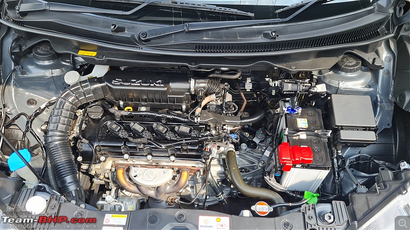

A Clean engine bay is car-gasm for me :
DIY: Servicing my Maruti XL6 myself-20211006_093048.jpg

Excellent job on your XL6. I love your clean engine bay pics, whether of 800 or this XL6.
Even I intend to get the oil changed on my S Cross after every 5000 km, since the engine starts sounding gruff after that even though the oil feels sufficiently fine and consistent.

Meguiar's APC diluted 1:4 and some brushes. Then washed everything with garden hose and dried all traces of water using a leaf blower(I use Stanley's). Finally, all plastic and rubber parts in the engine bay get sprayed with Water based dressing, in my case CarPro PERL.
